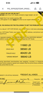

    3k over as in 43,000? Running ga and al?
    Gatordude, AFC, cke and 2 others Thank this.

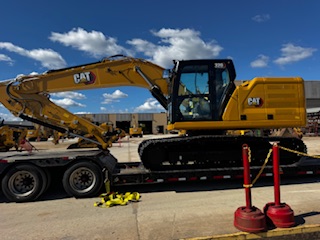

    Arrived at truck stop and checked cat scale. I was over 3k on drives. Fueled up and parked and reworked the load. Remove all securement and resecure load. Checked cat scale in the morning and was over 1700. Didn’t check night before. Didn’t want to lose parking spot and reworked the load again. This time I got it right. Took pic of where the load needs to be on my trailer. All photos attached.
    I do plan on keeping all notes. I will use all suggestions. Not here to reinvent the wheel. Much appreciated.

    The picture of the excavator.... you can load it all the way to the rear and swing the arm around the front......
