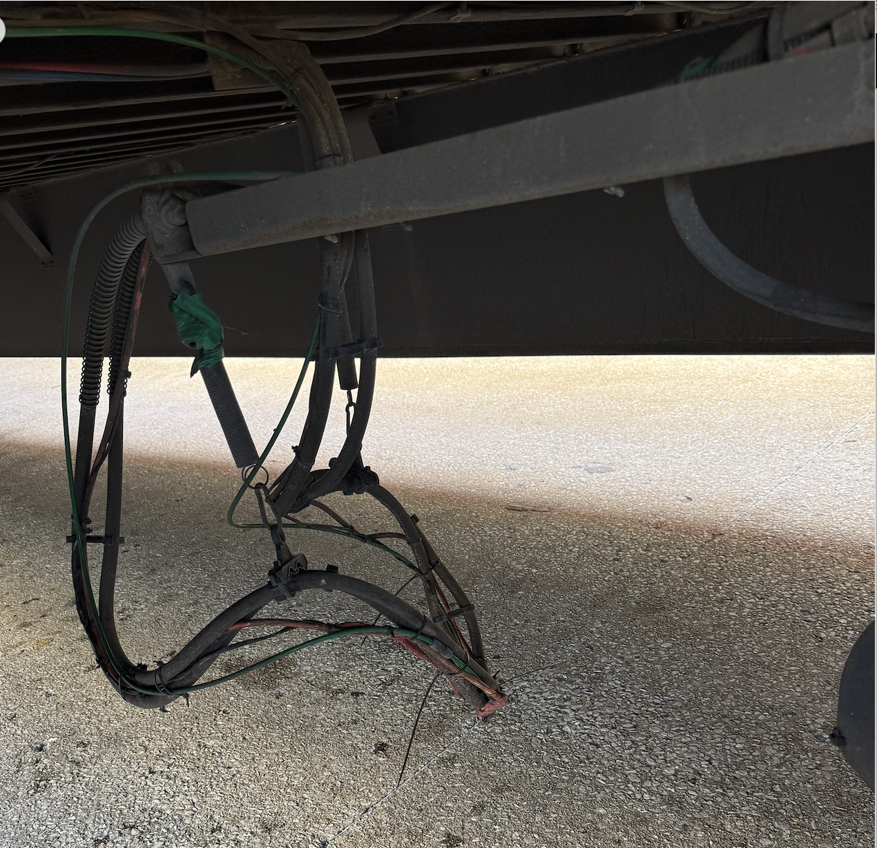

What is this called or maybe part number or location to buy link?

    Dry van air hose springs for undercarriage? Dang spring broke again and need to buy a replacement. It was too dang cold to fix the wire so I will do that after it warms up. Just need a location or name so I can look it up. I want to order one online and not go to the dealer to pick one up. Screenshot 2026-01-23 at 5.21.11 PM.png

    Slider hoses. Should be able to find #'s on Fleetprides website. Make sure you verify you're ordering one with the the correct bulkheads and correct length.
    I normally just buy the bulkheads and make my own hoses.

    Go ahead and order hanger spring, and hose seperator too.

    Stop at a TA/Petro they’ll have something for you. Forget which Petro fixed me up when I had problems with mine but they had a large selection of springs.

    Use 2 springs in different locations. Check that each one will still keep lines off ground if the other breaks. I’ve noticed that’s how they’re set up new. Had to quick repair a few lately. Bend the end, unwind spring, slip it back on, twist it a few turns, letting it wind back u to original. Stays put.

    I’ve had those hanger springs break going down the road. Luckily it only rubbed through the blue line and just made it a little harder to stop.

    Since there's currently crap weather everywhere, keep an eye out on these hoses.
    They build up snow and ice, and get heavy enough to hit the ground, even with good springs

    Yea I have a few extra carabiners that I keep for this reason. Use it instead of messing with the wire. Then tape the #### out of it afterwords.
