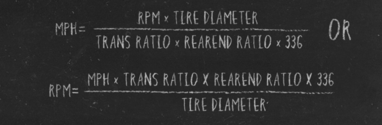

    I have been reading many posts but still need help.
    I am looking to buy a 2016 kw t680 mx13 500hp, 18 spd manual, with 3.7 rear ratio.
    I am trying to find out what rpm it will turn at 65mph ,??
    I pull a dry van with 20-30k lbs.

    Roughly 1410rpm. Google road speed calculator.

    Well at 1410 rpm, why would the fuel mileage be so poor ?
    Isn't this an ideal rpm ??
    And should be good on hills.

    At 65 you will be on the upper end of where you want to run the engine. The torque curve on the MX is low (1100-1400 rpm). If your plan is to consistently run 60 to 65 then it won’t be bad.
