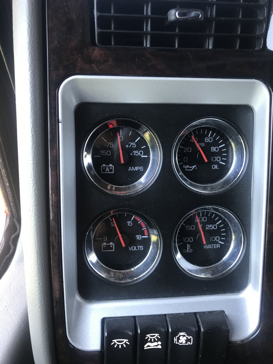

    I need a good voltmeter. I don't think Ive ever had one before. Ill post the picture in the next post of issue that came up today. Trying to determine if its my alternator or batteries

    I didn’t get a picture of it but my battery voltage is low and the warning light on the amps was on. When I turn on headlights they are dimmer than usual so I know something is up.

    Your belt broke or more than likely your alternator has moved on to the after life.

    Yeah I checked my belt and everything and no problem. So, Harbor Freight will be ok?

    And where should that AMP read on the gauge? Because ever since I bought the truck its hovered around 0 but, my voltage on batteries was always around 14
