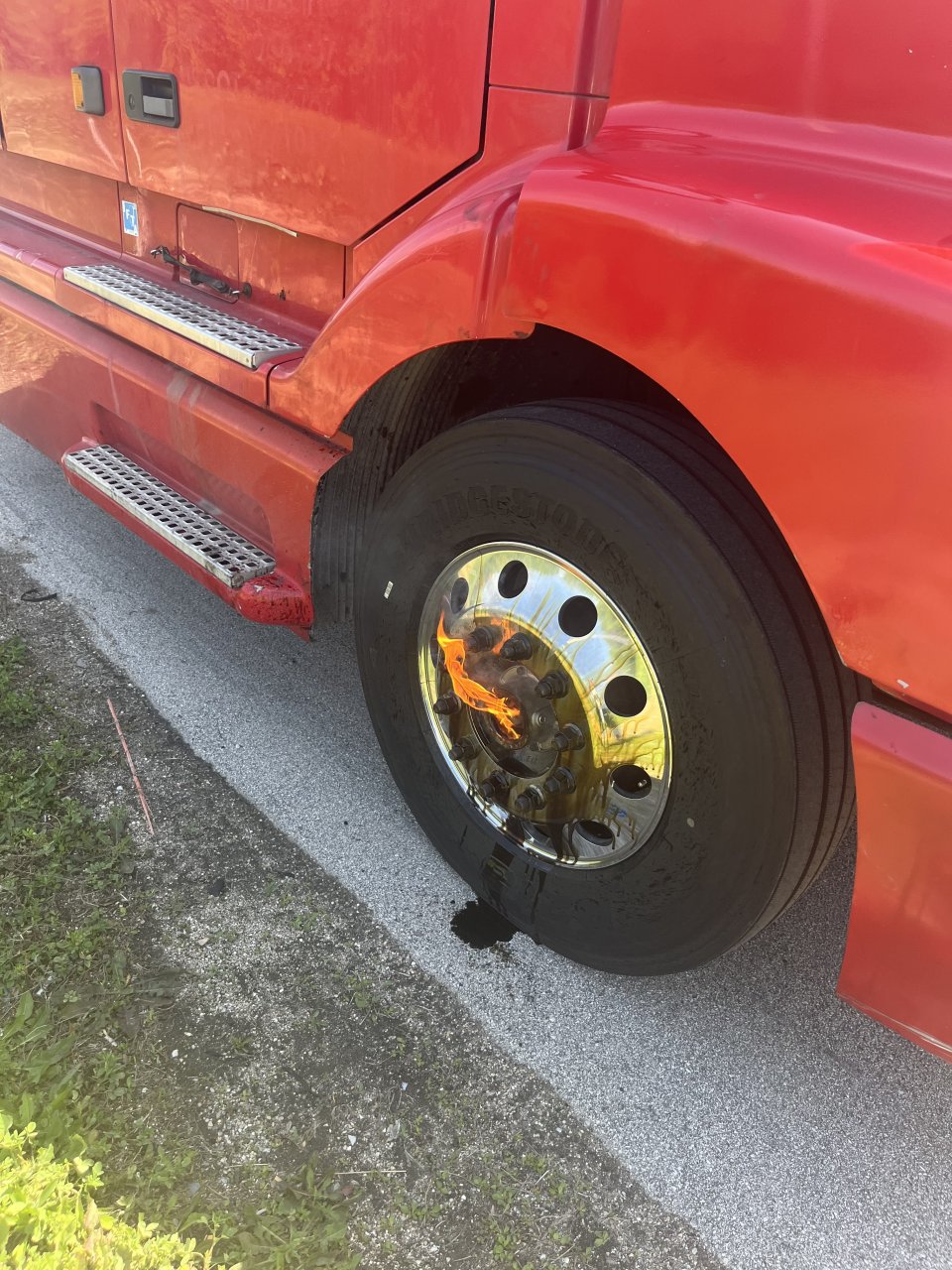

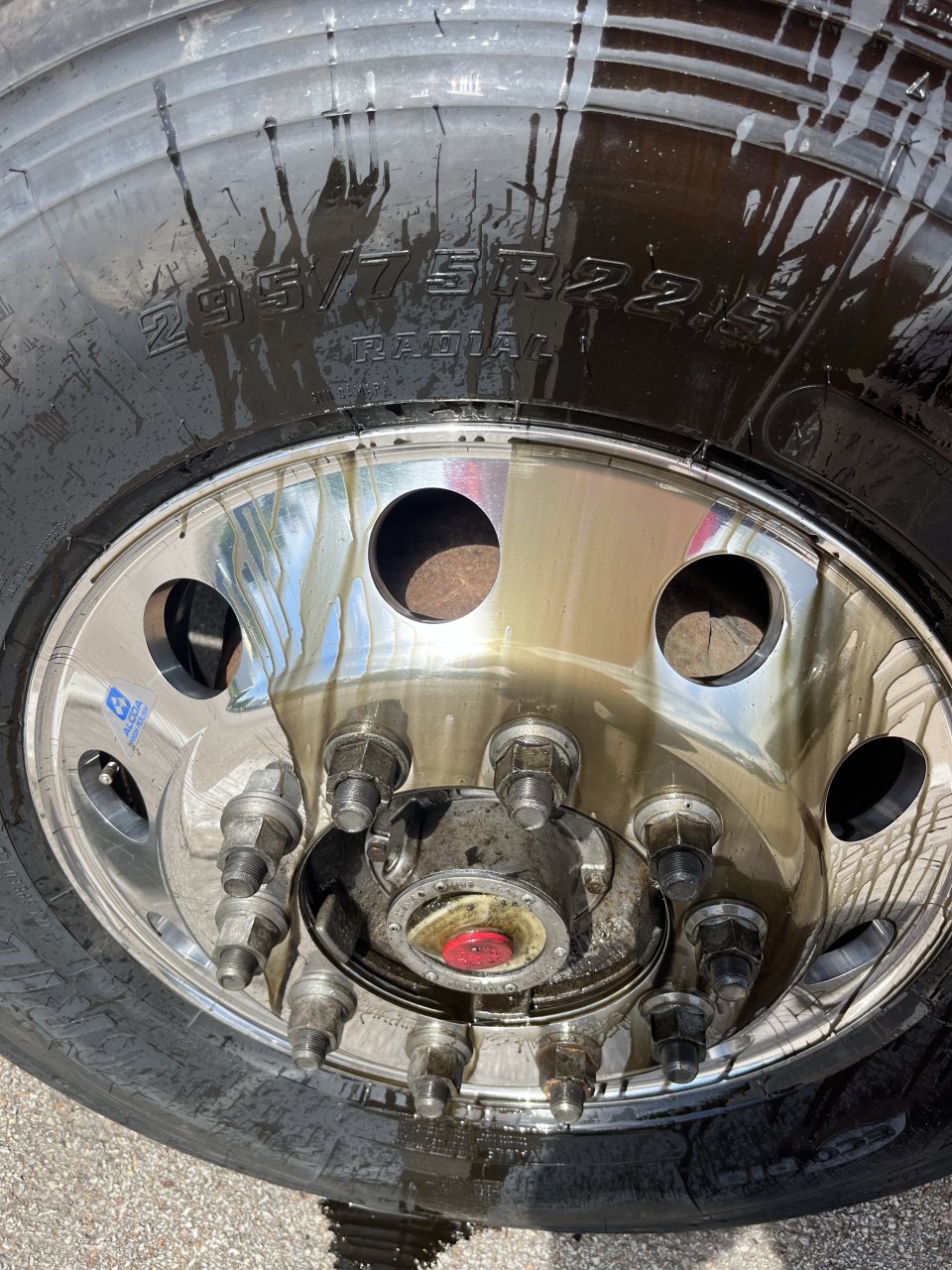

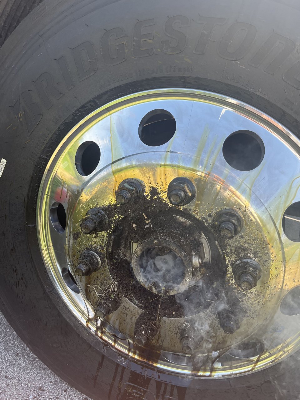

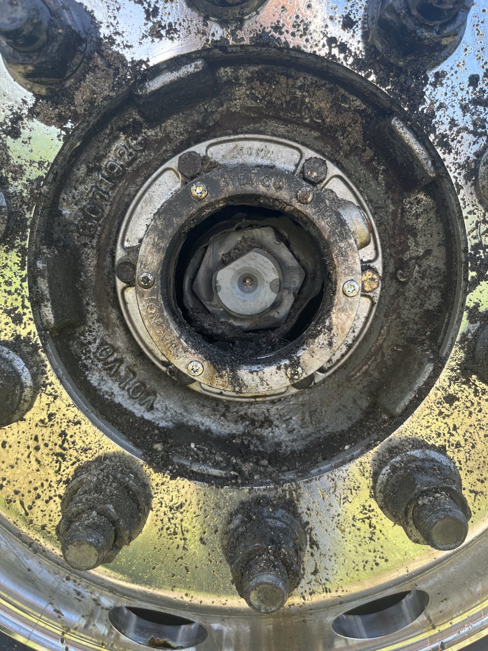

    Wow both hubs melted one i cought late other one early
    Why is this happening guys?

    Yea just replaced hubs and wheels

    Bearing nut too tight or not enough oil. Maybe both.
    How many miles did you drive since repair?

    You didn’t catch anything “early”
    I would be getting a second opinion on the damage before I brought it back to the original shop.
    Actually I probably wouldn’t let them touch it again..

    First hub 30 miles second 35 miles week later,shop owner is gonna cover towing which is nice
