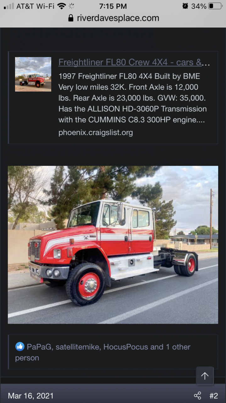

    I’ve seen some utility companies use crew cab 4wd medium duty freight liners
    And international I think
    and the older Unupdated platform would be a plus to me .
    Lot less computers and complexity and crap to break down .
    singlescrewshaker Thanks this.

    The 4wd will cut into the mpg quite a bit .
    The is one was $47k
    singlescrewshaker and Stillgar Thank this.
