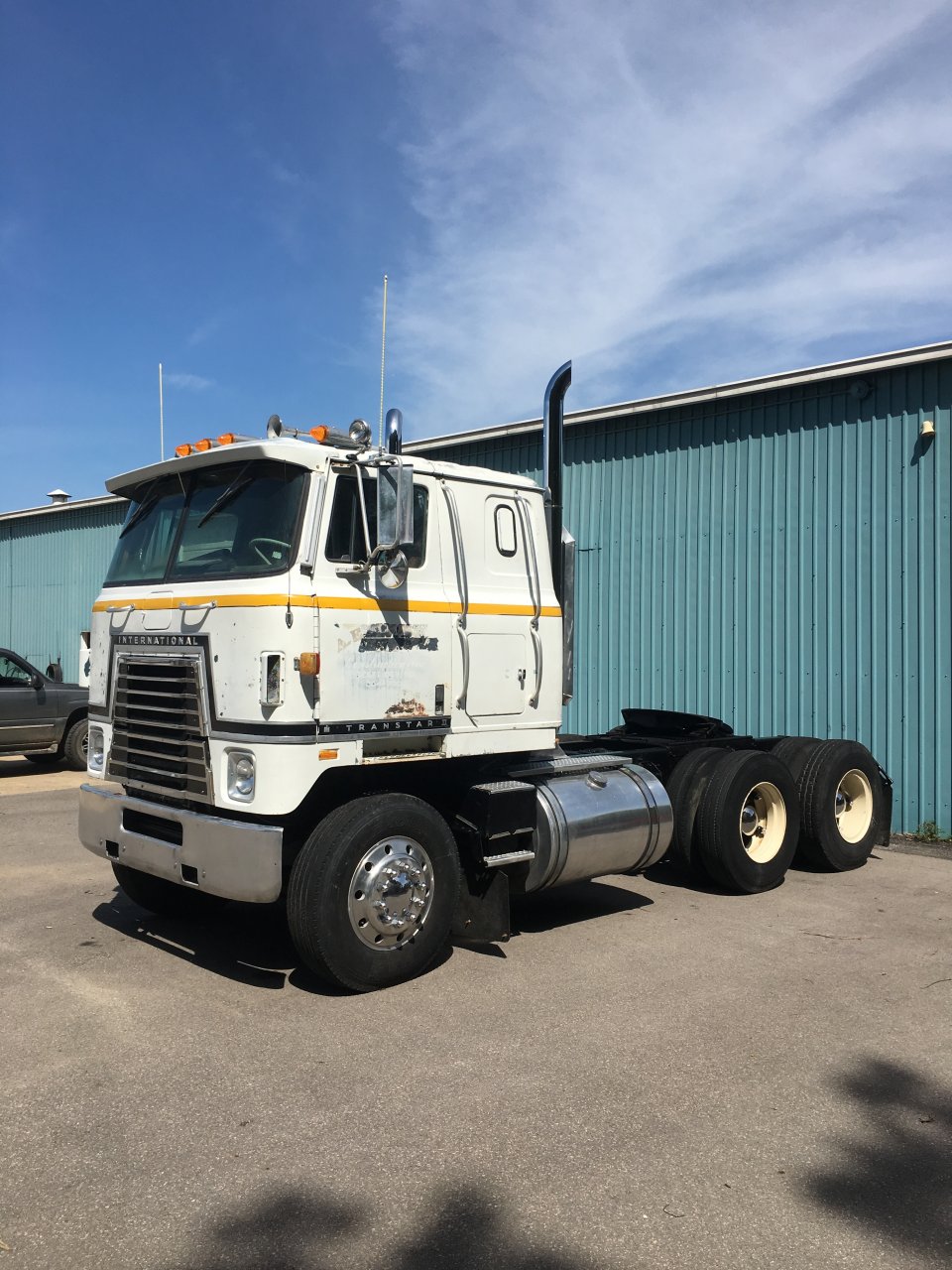

‘77 4070B, 290 SC Cummins, 13 speed and 330K original miles. Wanted to rescue one of these before they’re all gone. Love this truck. Other than the usual hate mail( rides rough and pita to get in and out of) do any of you guys got any advice.

Keep an eye on the drag link down below. And write on your heart those cab locks back there need to be engaged.
A winterfront for winter is something you need to look into. It gets cold up there by your knees. And your engine can use a little love in that way to keep it's temperatures up.
You are going to constantly check those hubs, 5th wheel adjustment if there is one and suspension hangers etc. Maybe a little more than most tractors today. You will never be satisfied with a once weekly pretrip. These older iron will know when you are not keeping a eye on it and develop something somewhere.
If your airhorn does not have front covers, get them installed. Otherwise they will choke and fillup with snow, ice and whatever else.

You are probably running air fed wipers. You will find the rotating metal knobs for them as a pair near your brake buttons. (If you have two buttons, great. if you have three, then one is the supply only for the trailer. Separate from the other two.)Bean Jr. Thanks this. -
if you are going to restore this, you may have a tough time getting "some parts" like body parts. the junkyards that have some of these old relics are drying up with parts that are in demand.

The Transtar was a good, solid, very popular, and affordable OTR truck back in the day. Heck, they were everywhere once upon a time. The 290 Cummins was also real common then, as was its cousin the screamin jimmy. Only the 290 didn't hemorrhage oil like the Detroit. Does this one have P/S, A/C and air seat? Many didn't from that era.
How did this one get this far in time with only 330k miles? Check it out real good, should be worth something down the road if it's in good shape, good luckbzinger Thanks this. -
