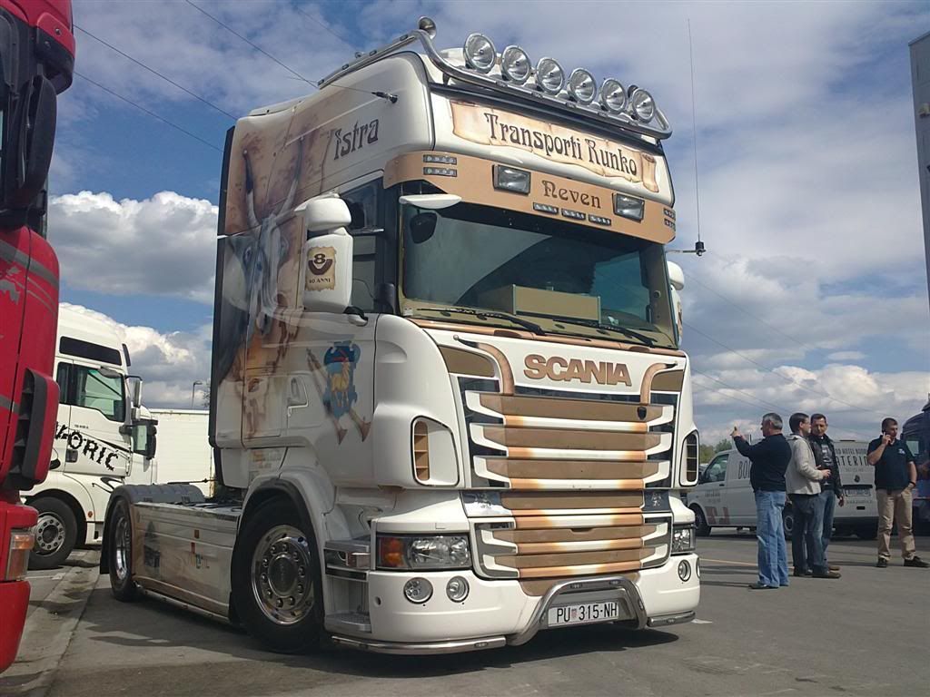

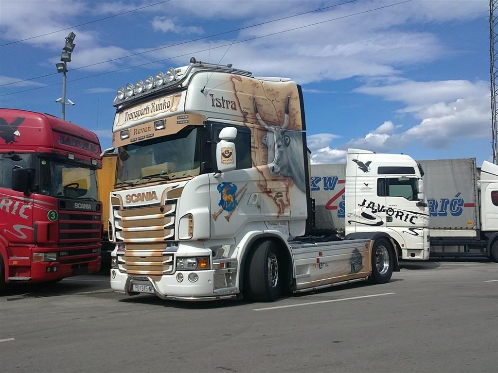

    You have Scania's too
    [ame]http://www.youtube.com/watch?v=bEL1tCfLTQw&feature=related[/ame]
    [ame]http://www.youtube.com/watch?v=2GuJXOjLSYs[/ame]
    this one is from Newark, NJ and still working
