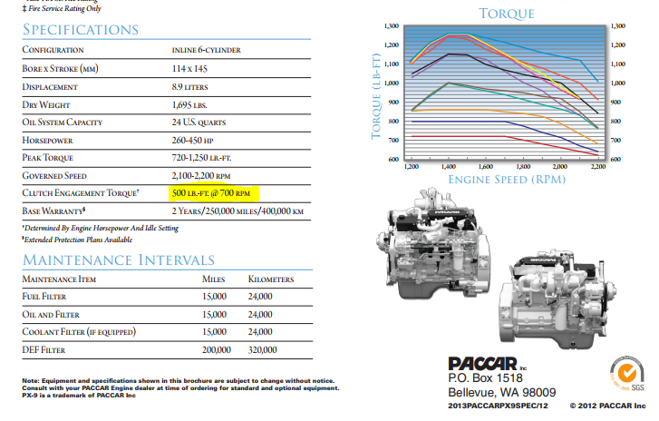

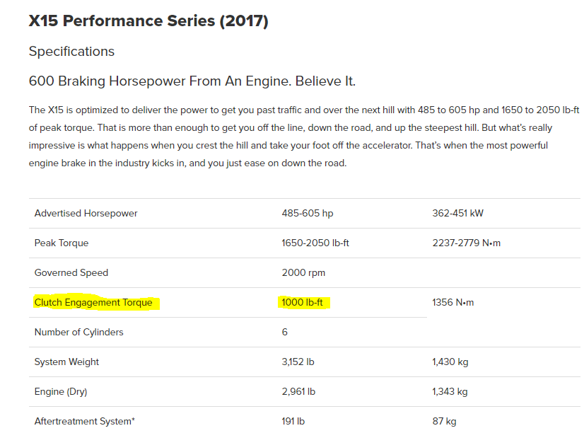

    And that my friend is why I did not go that way, and did not want to use my own interpretation of unknown and/or inaccurate data.
    According to Paccar, the 9 liter ISL (PX9) already has 500 @ 700 rpm
    You can't honestly believe the X15 is only 500 lb-ft @ 900, as it is in your chart, or do you?

    Please explain what you mean. I don't understand.

  8. KVB
    KVB Heavy Load Member
    877
    2,875
    Jun 30, 2012
    Sorry, but I'm afraid your assumptions are not correct, even after your correction.
    700 @ 900 rpm? So the engine looses 300 lb-ft from 600 to 900 rpm?
    Well, to be honest, it does not say 600 rpm for the Clutch Engagement Torque, could be 650 as well, or even 700. But I don't think that it really matters.

    It's very simple, take the graph from the Cummins site and extrapolate it yourself to 900 RPM. Unless they made a mistake with the graph, you will end up at 700 lb-ft.
