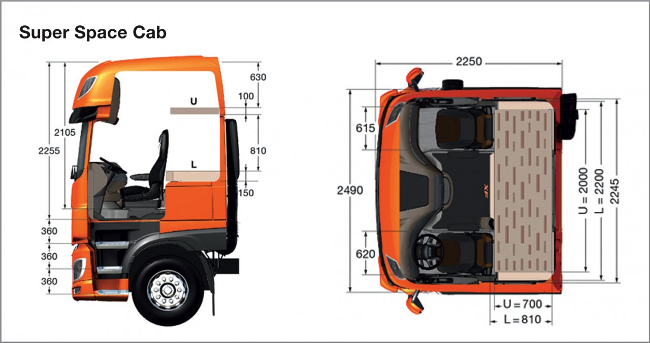

    I hope if you are in the top bunk you have some sort of safety net or it is out the front windscreen during hard breaking.

    There is net, it is not allowed to sleep while driving
