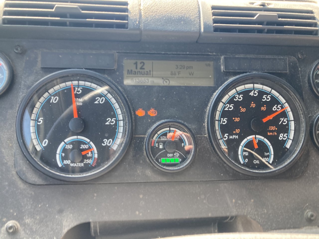

    That’s The MIL, Malfunction indicator Light.

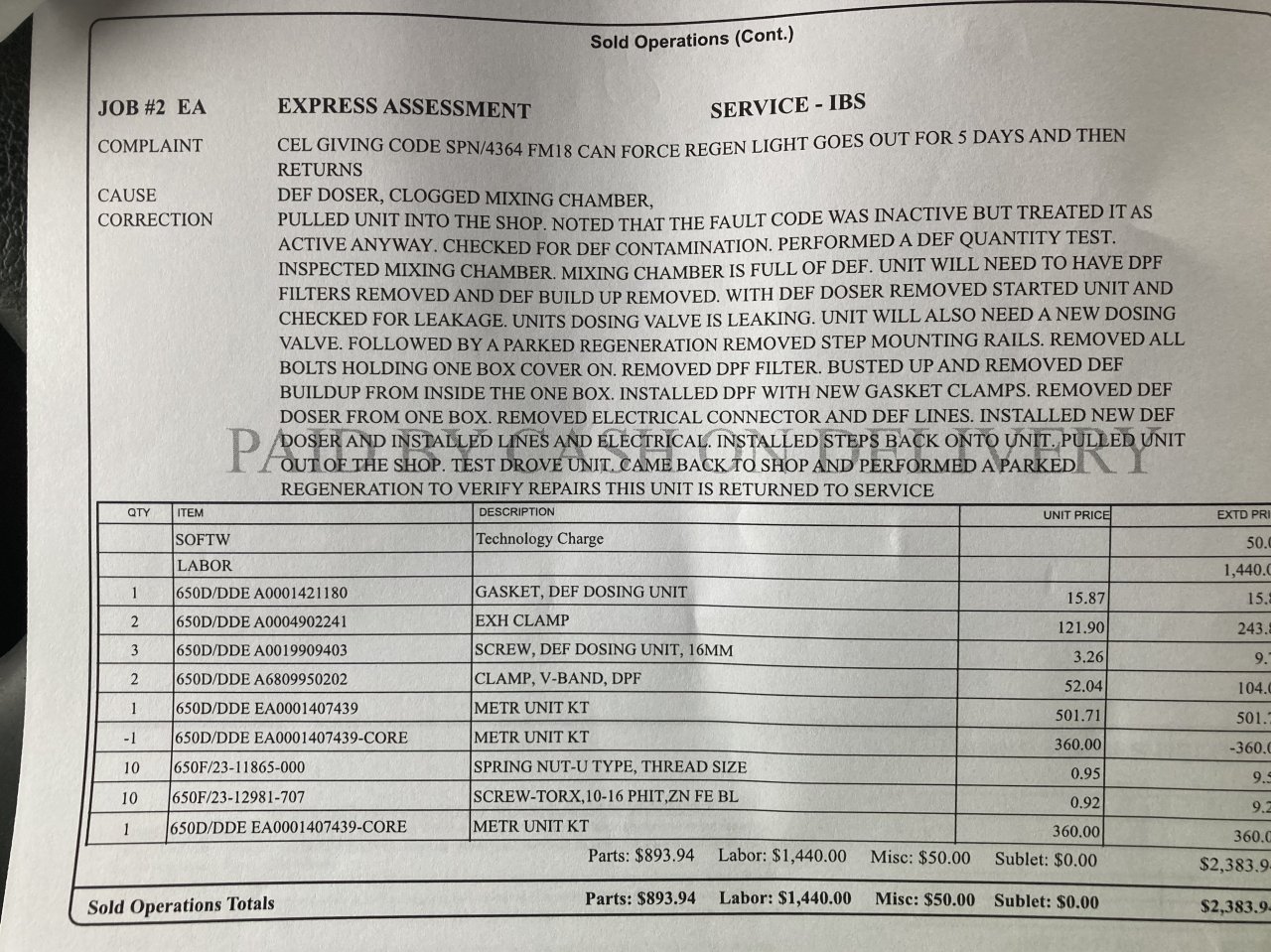

    mine was just fixed, mine was doser valve was wollered out and leaking DEF into mixing chamber, a lot of it, they scraped a 5 gallon bucket full of crystallized def out, and put a new doser and an awning to stop that.
    Sometimes it was just the MiL light if you kept driving it made you do a regen when both were on.
    when the yellow light next to DEF level flashes yellow, it’ll derate to 55 and lose 25% power.

    Yes, mine is 16 Cascadia, too.
    As you said, when the yellow light flashes with the engine check and DEF yellow lights, it will be derated to 55 and lose 25% of its power.

    yep, they will have to remove fairing under passenger side door,probably replace doser, clean all that crystalized def out mixing chamber and do the awning Freightliner in Jonesboro AR said about $3400 estimate.
    was actually $2900. 1 day job there, their mechanic knows what he’s doing on DEF systems

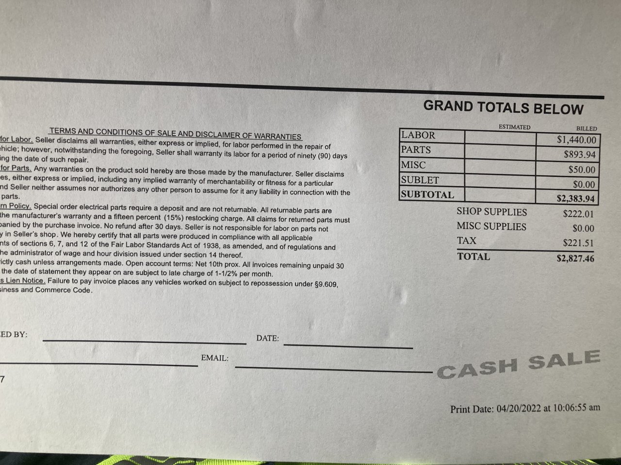

  6. Judge
    11,175
    71,444
    here’s what they do.
    parts/cost etc. 47CEE015-FE51-4CF5-8C85-65641016E52F.jpeg
    carson_77 Thanks this.
