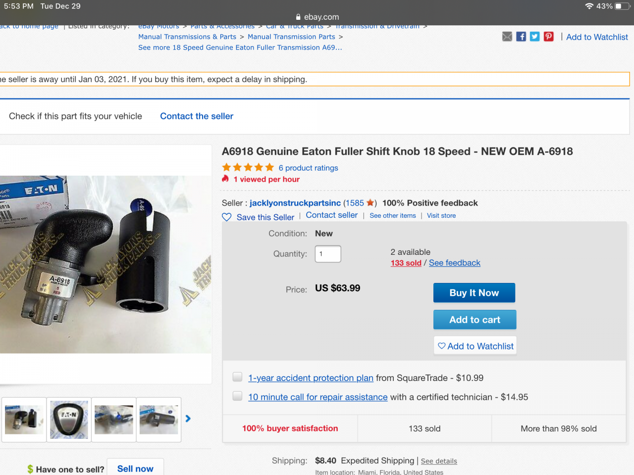

    This is about what I paid for it at Pete. Probably any truck shop would have them.

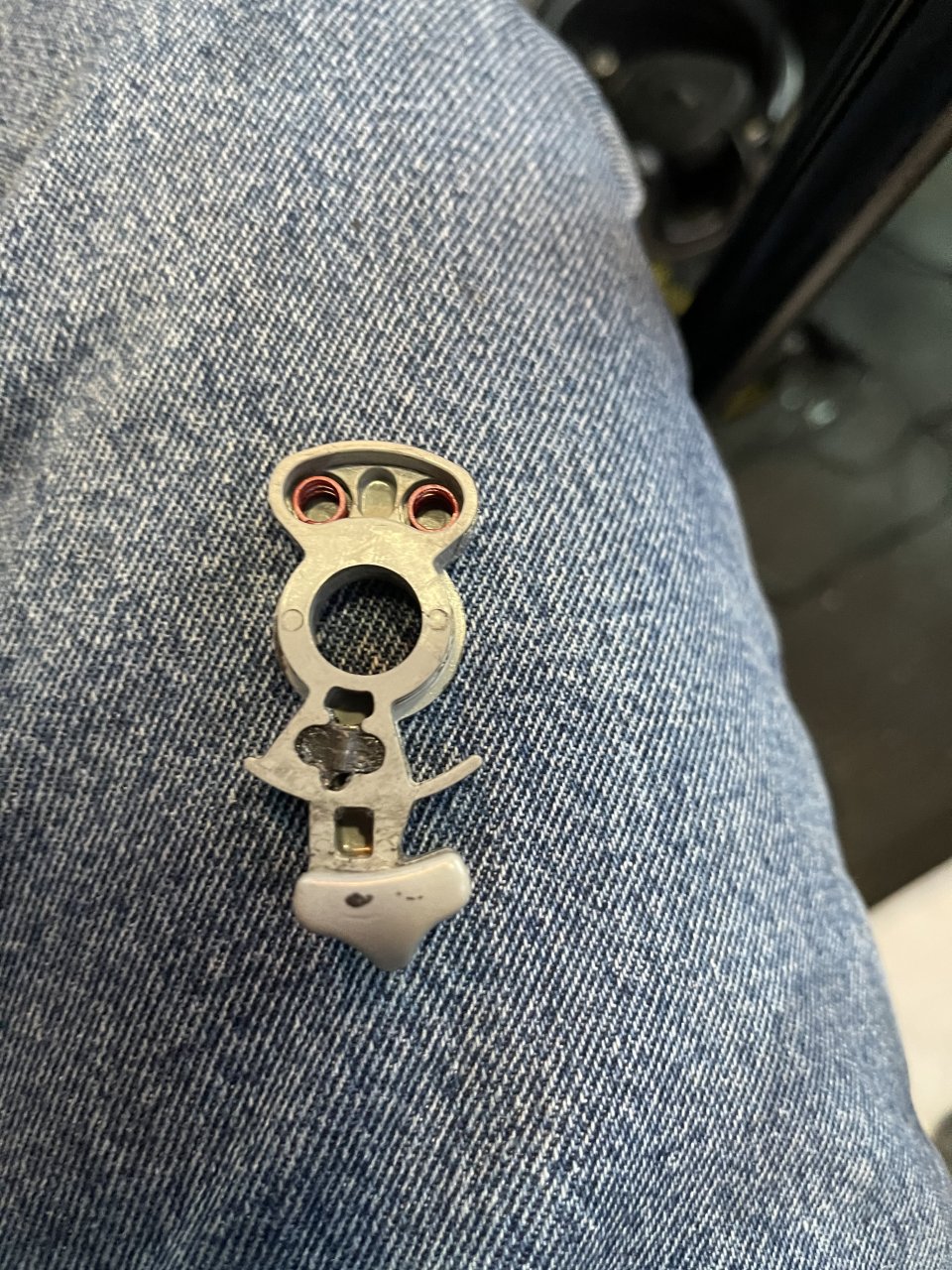

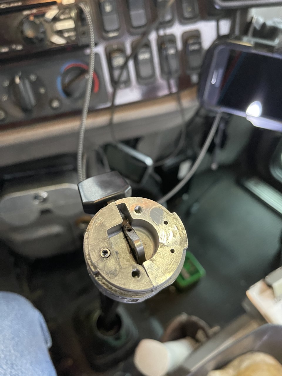

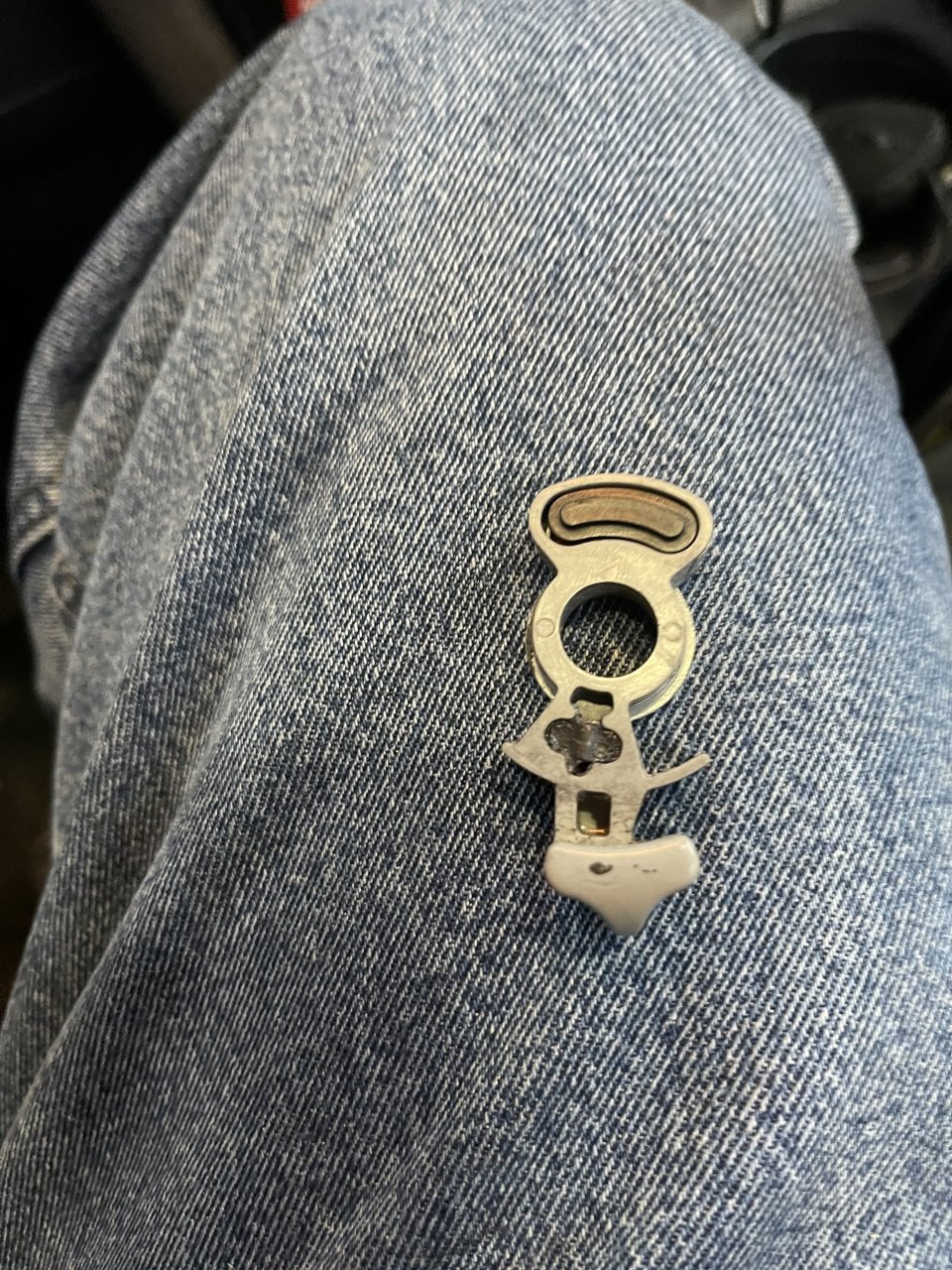

    DDC75FE5-A2E3-4098-B0E9-5EB9EB500A4F.jpeg 34F50714-5A54-4243-9EE1-618102C1B13D.jpeg 6FD5A349-8EA8-42D7-A927-52B8BD0BAD99.jpeg Be careful if you take it apart as there is a small ball bearing in there also. Vaseline can be used to hold it in place to put it back together. If you buy a new knob you won’t have to have that part open as you can install it sealed. The price wasn’t worth the hassle for me so I just replaced the entire knob.
