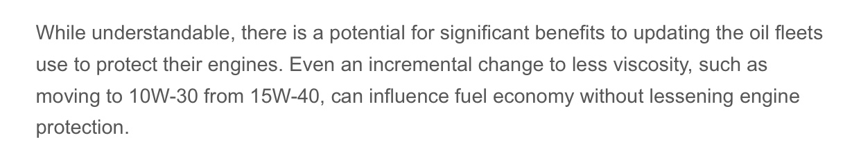

    thinking of switching. Anyone done so?

    Same lubrication with less viscosity to lower engine friction

    Just doing some reading and thought I’d ask. I’m just looking for ways to improve my business.
