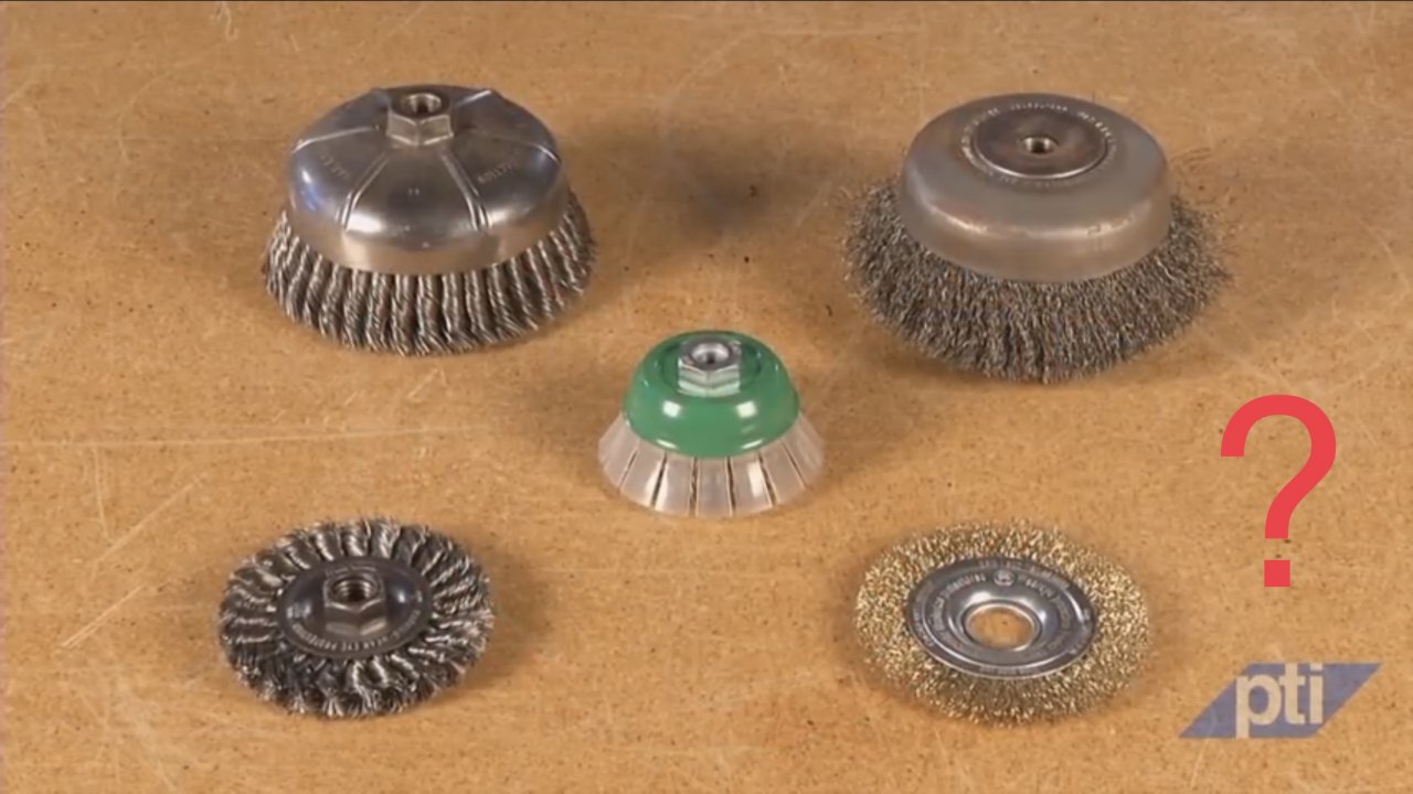

    So what purpose do these brushes have? Wire wheels, wire cups,...? What about different materials such as steel, brass,...? What are the basics for an amateur trucker mechanic?
    What type of gloves to wear for safety?

    Wire brushes are the preferred tool for clean up of steel and cast iron parts, be it axle, engine or whatever. They contain no abrasives and will do little damage to the parts and leave the surface free of rust and debris and make quick work of it too. I prefer Weiler Brand wheels. Twisted and Stainless steel wire only. Non twisted and plain steel just don't last and if you are using a air dye grinder they are rated at much higher RPM. Not to be used on aluminum parts as they will remove material if your not careful.

    Removing rust, gasket material, or oxidation without grinding away too much of the base material like sand paper or a grinding wheel would. Brass brush wheels are softer.
    Cleaning without needing to totally rape what you want to clean.
