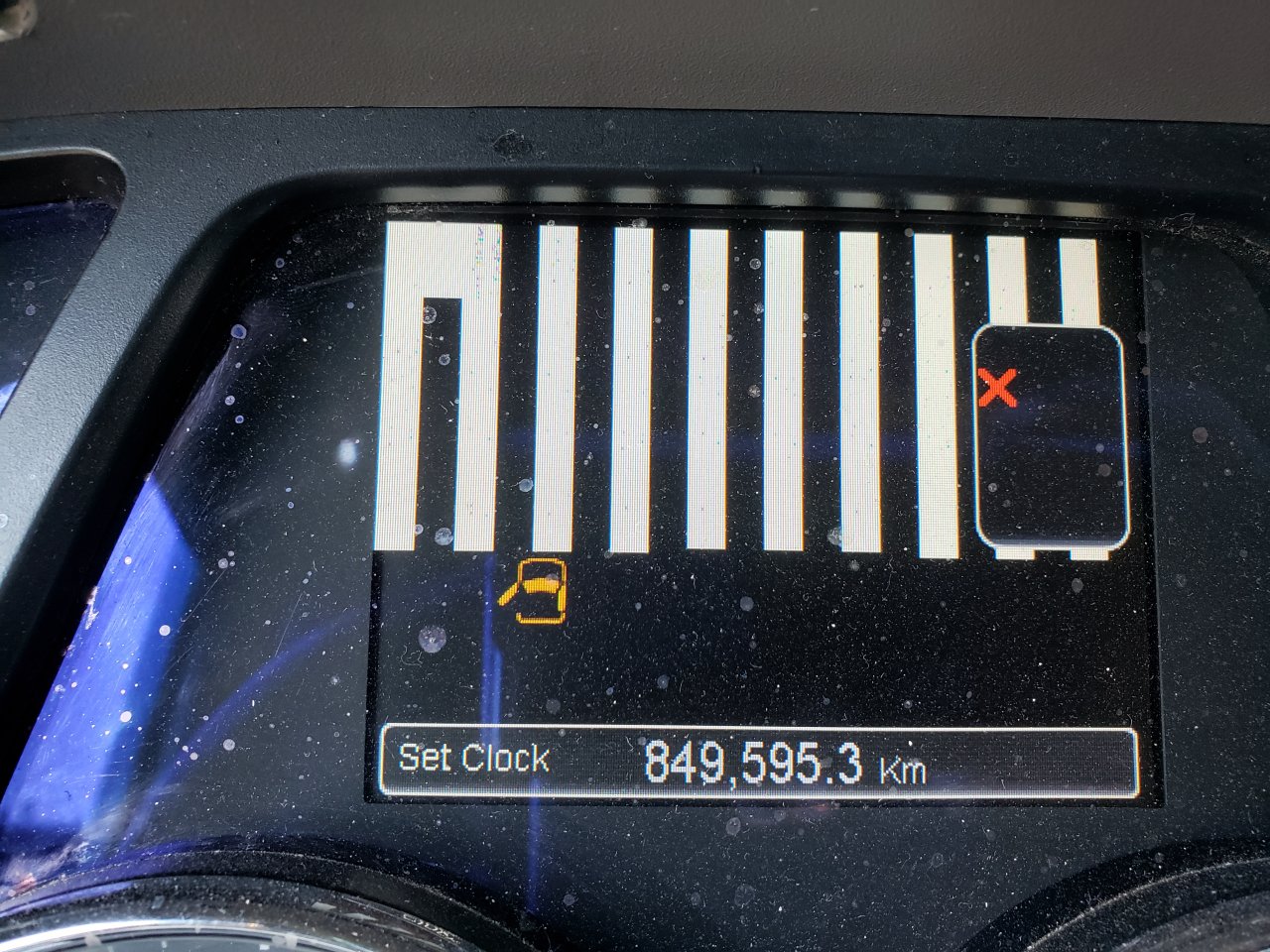

    Same thing is happening to me right now in my 2014 Peterbilt 579.
    I just changed all 4 batteries with brand new ones.
    I took 4 days off, came back to my yard and completely DEAD. I charged with my personal car with cables but it took and hour and a half to get it going.
    Man I hope that drain doest start messing the the starter but it did this to my Dash Computer 20201016_124746.jpg
