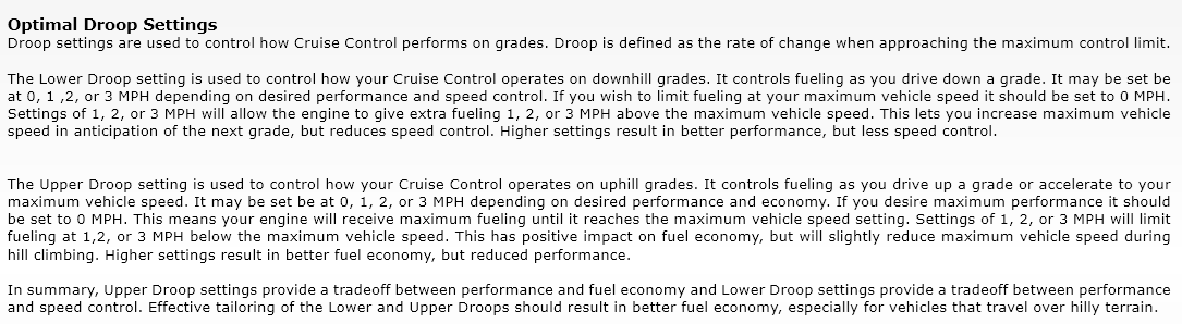

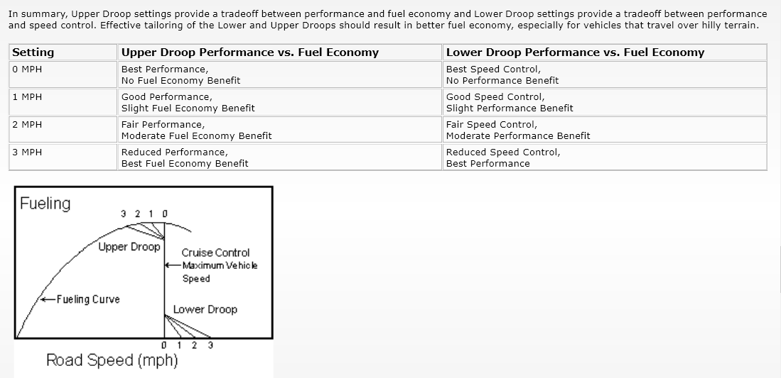

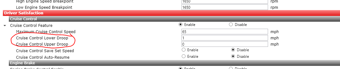

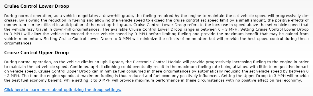

    Cummins (at least on ISX) uses droop to achieve more or less the same thing. Images below are for EPA201 ISX:
    If you have Insite or have access to it, you can check these parameters and try and play with them to see what you like best.
    IH Branded Thanks this.

    I have one and have the upper and lower droop both set to 3mph. It works well for most terrain. Also need to change the amount over cruise set speed to enable engine brake to be greater than the lower droop setting. Think mine is at 6, so if I leave cruise and jake on at set speed 63 in 65 zone it will keep the fuel rate pretty steady between 60 and 66 and will put engine brake on at 69. It does make it similar to driving using the pedal with an egg under it. I like it. You can still beat the system mpg wise using your foot, but if you ask a driver to do that he will want some form of accessorial pay.
