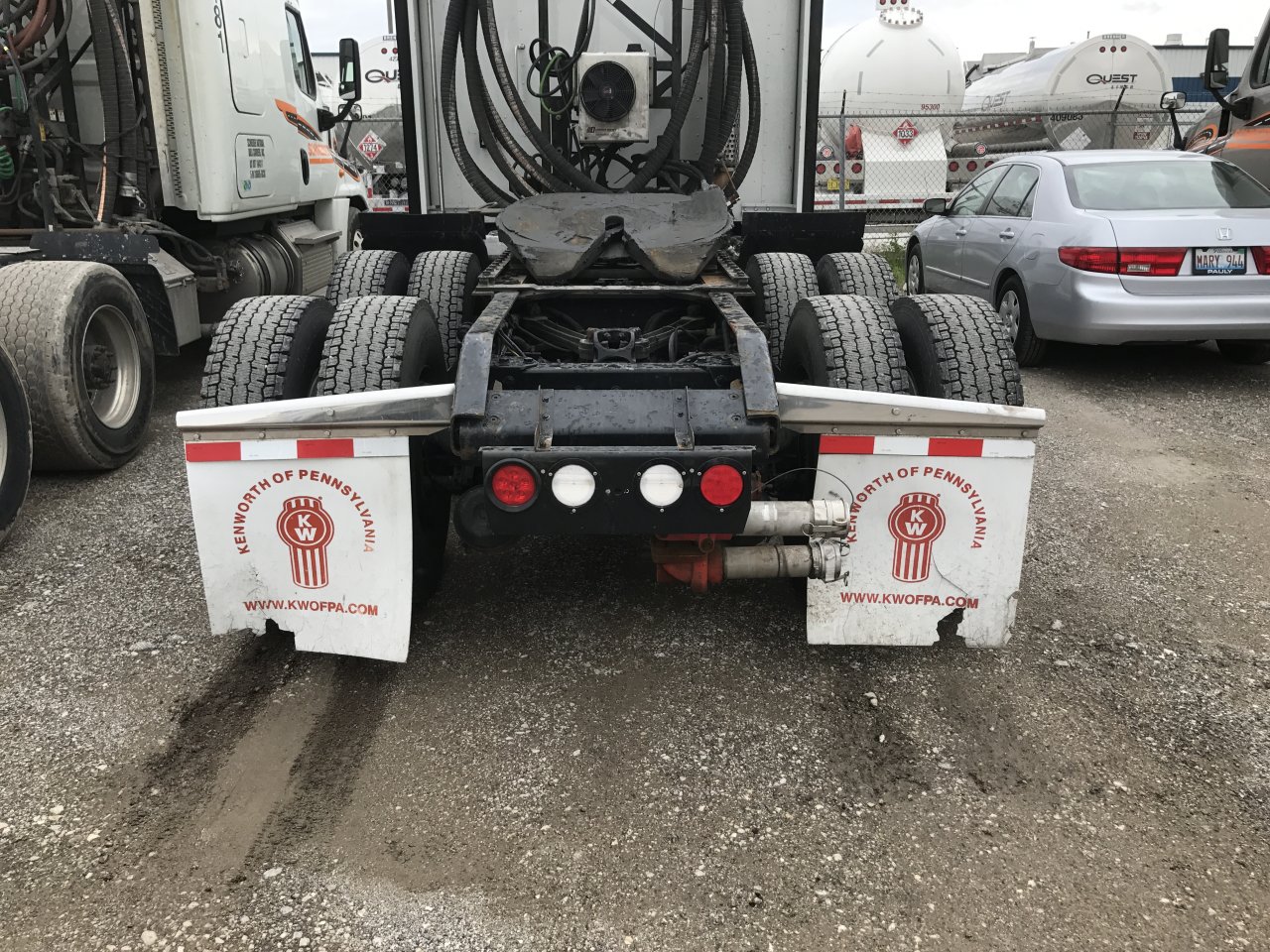

    Mount it on the rear of the frame.
    0C445881-19D1-46F8-B75E-6C14B0609DEC.jpeg DCC1FE6A-9F4A-42B8-BFD2-3E61888D3A50.jpeg BB1CB040-1FD0-4173-9333-63DDFF16E566.jpeg
    Gulf Thanks this.

    Wow, never saw that kinda' set-up. Mildly inconvenient I suppose. How does it work for you?

  10. ChicagoJohn
    ChicagoJohn Road Train Member
    Joined:
    Jan 14, 2016
    Messages:
    2,388
    Thanks Received:
    2,749
    Location:
    Chicago
    That was a company truck setup. I wanted to do it myself, but it was going to be a PITA and I had the room behind my tank.
    I drove the company truck for 6 weeks while I was doing an OH, it was great. Only needed 1 hose for a center and 2 for a rear. Instead of 2 & 3 line now. We very rarely need to pump off, so I deal with it, but if I was pumping a couple times a week, I'd spend the money and mount the pump on the rear for sure.
