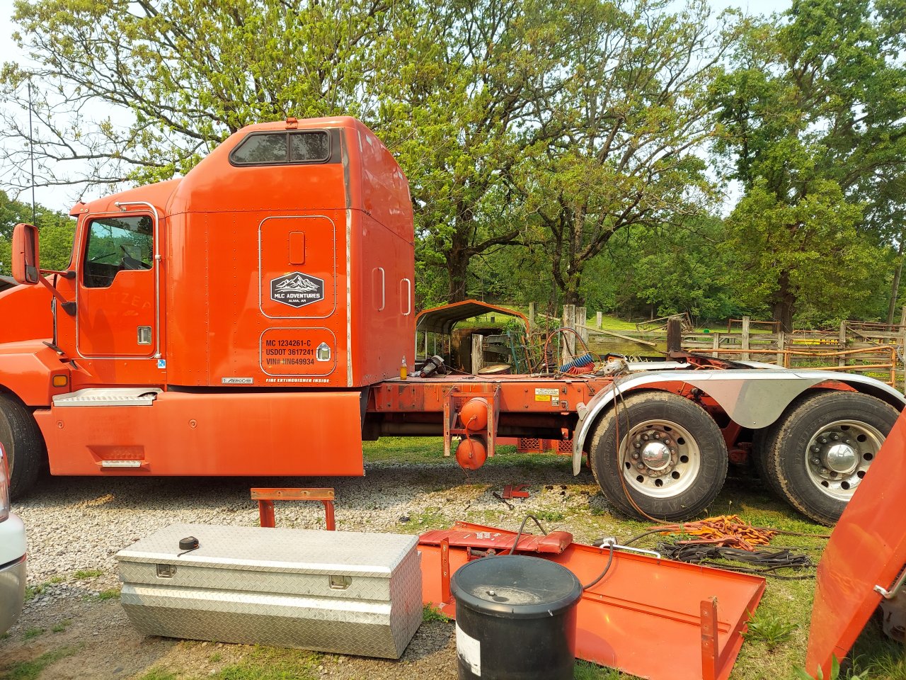

    I would buy a cutoff personally, then make it whatever length you want. It's really not as hard as you would think.
    The Pete suspensions are ok, but later Volvo and Freightliner are easier to work on and align.
    Here's a 250" WB. Lotta room between the nose of the trailer and the headache rack.
    This truck will have a Volvo suspension and 3.50's in September to get rid of the ridiculous KW 8 bag bs 20220430_103618.jpg

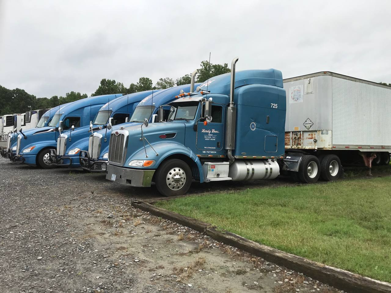

    Gotcha. I'm usually leary of chopping and welding frames, I'd pay a shop to do that since I can't weld, but with as much 300" wheelbase trucks out there that I see, clearly it's possible...
    And that's an impressive amount of room for 250", the one in the yard looks nothing like that space-wise. Although I wonder if that's because it has cali fins on the sleeper and air dam or if it's because the WB is even shorter than I thought...
