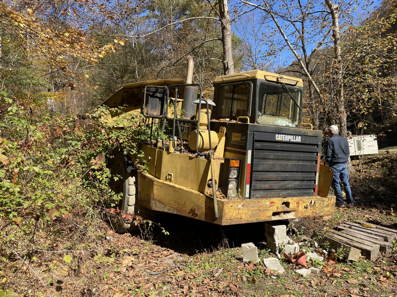

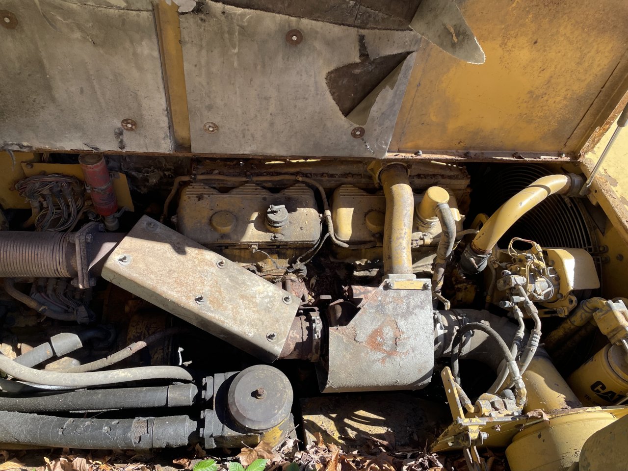

    BD822E5B-41EB-4FB4-9454-38D80DE5DDD5.jpeg D25B11A2-721C-49DA-A394-5397783F1D01.jpeg 70151F64-E019-4ECB-B6C0-909F4BBFE261.jpeg Don’t know a lot about Cat’s myself…. But I was hired to haul this Cat dump with a 3406C out of a holler here in WV to Kentucky. It had set for 2+ years untouched, as the owner had passed away.
    Checked all the fluid levels, installed new batteries, and shined a light in the fuel tank which was very clean actually.
    I was surprised that with only 3 turns of the crankshaft it roared to life, and the oil pressure came right up. Obviously a good tight fuel system.
    If it doesn’t start with minimal cranking don’t burn the starter up, check the fuel filter and replace if needed with new fuel….
