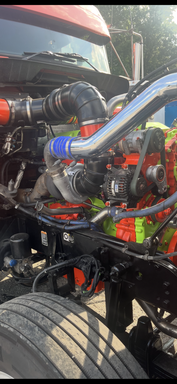

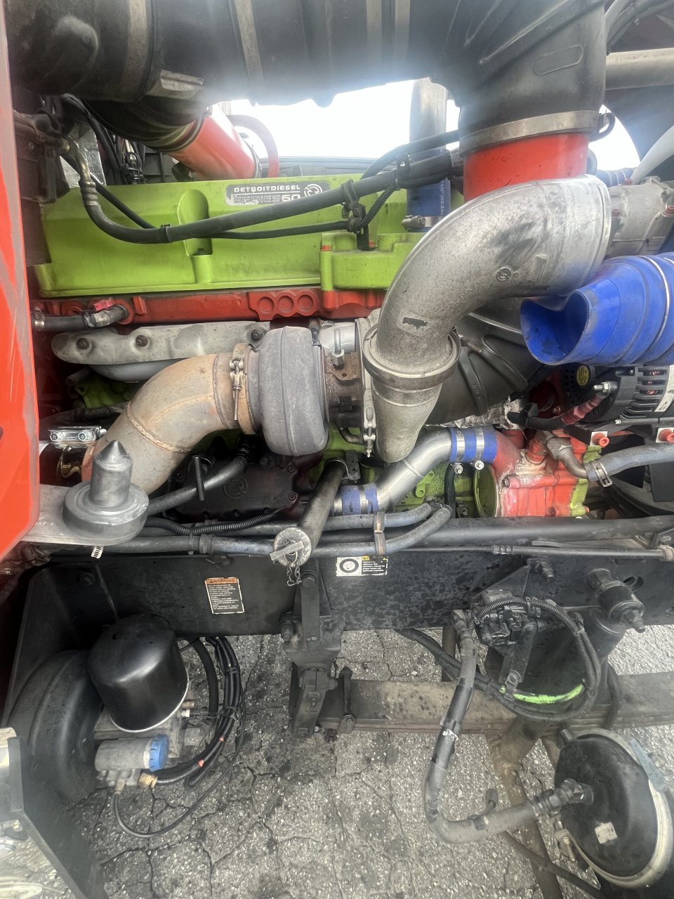

    I have a 12.7 and im gonna be changing my own turbo. I do a lot of stuff on my own. Never have done anything like this. I believe I have the tools, ive watched videos and have gained massive confidence in myself doing this job.... :)
    Ill post pre/post work. From everything ive seen. its more or less, remove and replace. No need to disconnect the batteries, etc. Im typing this after I sprayed a few bolts with PB Blaster. Giving it a few to soak in. Ive taken the week off...... Im hoping of course it only takes a few hours but, I dont want to rush doing it while under a load or rushing to do this needing to pick up a load.
    Any words of advice? Or anything I should know or maybe ive missed??

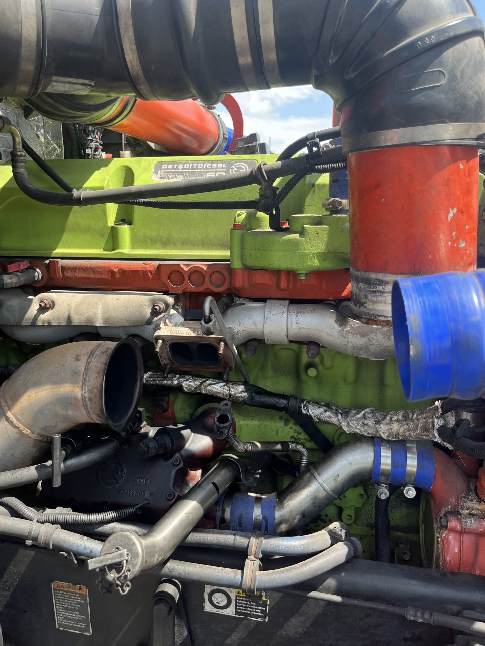

    Ok on replacing the nuts/studs in the manifold.
    The Return line...The line from the turbo to the oil pan correct? Ive got the gaskets and all of that came with the turbo........ do I need to use any kind of gasket maker/liquid on the gasket itself?
    Its actually going pretty good so far...both oil lines came loose easily. The top 2 nuts on the manifold came loose easy.......aI didnt have to fight with any of the clamps. Unless im missing something, only 2 left are the bottom 2 on the manifold.

    Nowhere near as bad as I thought it was going to be. I thought everything was gonna be seized up!!

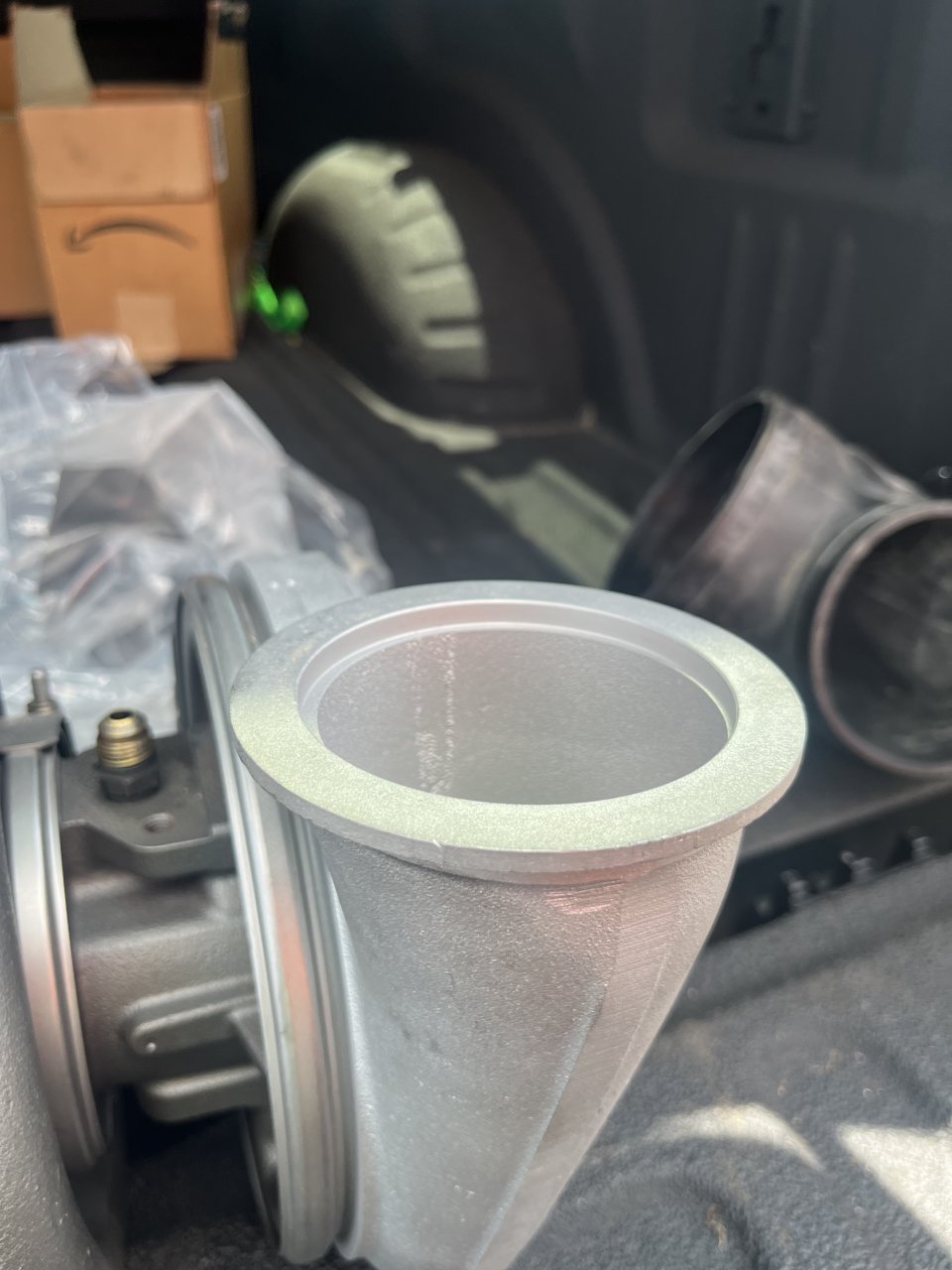

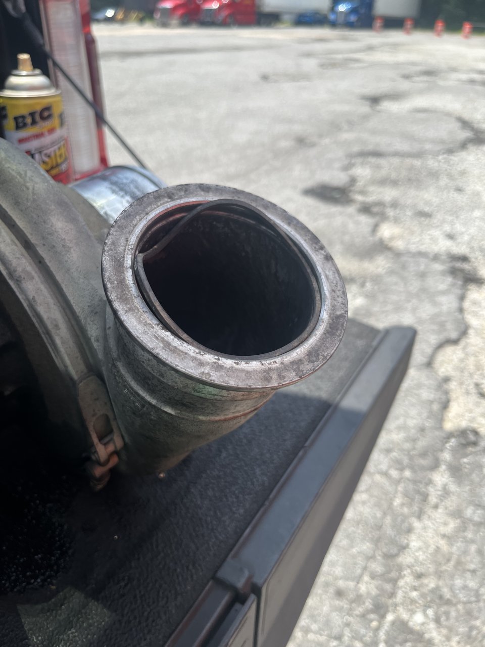

    IMG_2725.jpeg IMG_2726.jpeg I’m assuming I’ll need an o-ring right here as my new turbo doesn’t have 1
    D.Tibbitt Thanks this.

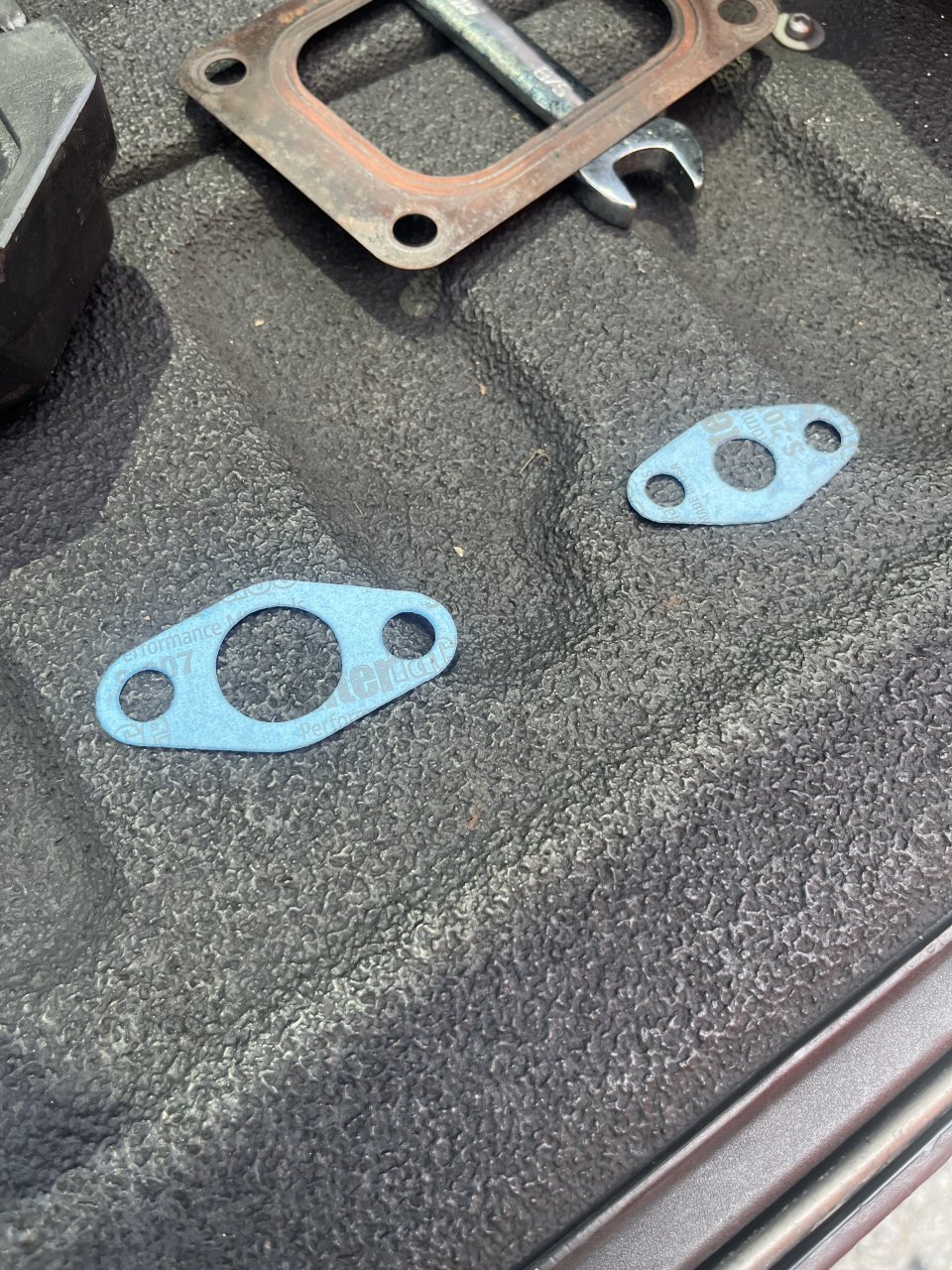

    IMG_2727.jpeg Also, I have 2 gaskets here. I know 1 is for the bottom of the turbo for the oil return line. Where does that smaller one belong?
  10. Big Road Skateboard
    Joined:
    May 2, 2021
    Messages:
    6,150
    Thanks Received:
    33,609
    You can reuse the o ring if you need to. If it's intact with no damage, I've never had one leak.
    The gasket that doesn't fit is for a different application
