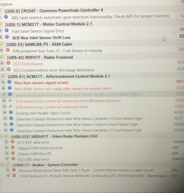

    1
    Thanks Received:
    Got these codes help please
