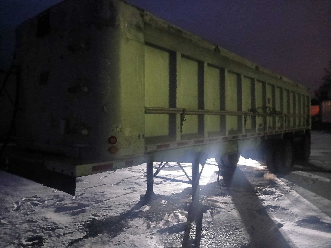

    Went and looked at a 1993 East 40 full frame all aluminum. Spread axle w/ lift. Aluminum wheels in and out. Hub pilot. Pretty straight for the year. Will need brakes on the rear axle eventually and probably a tire or 2. Good tarp and bows. 3 way gate. Can't really find anything to fault.

    yea, a full frame
