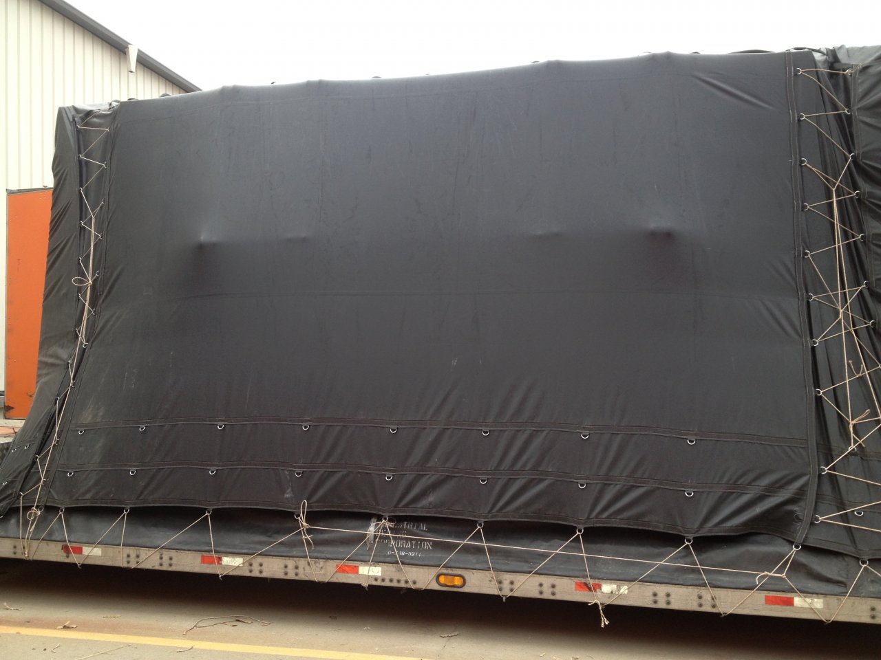

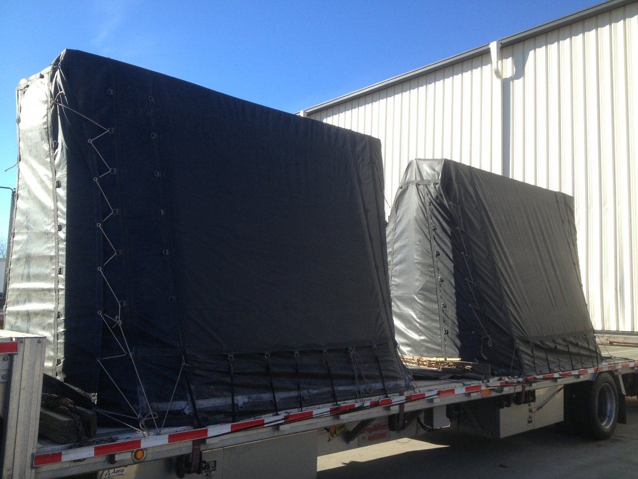

    I'm going to pick up some shock cord next time I get a chance because The rubber rope is kind of a pain to work with. I wish our trailers had hooks it would make it much quicker. I used to rope almost everything at maverick hauling glass. Looking at some of their drivers going down the road I'm not even sure they teach them how to use the glass tarps now.

    Those tarp jobs are a masterpiece of the artform.

    Thank you sir. They make it easy with purpose made tarps. Those small flaps are triangle shaped. At the end of my tenure with Maverick I was tarping 3-4 loads a night preloading trailers. Now tarping one load every once and a while is pretty easy.
