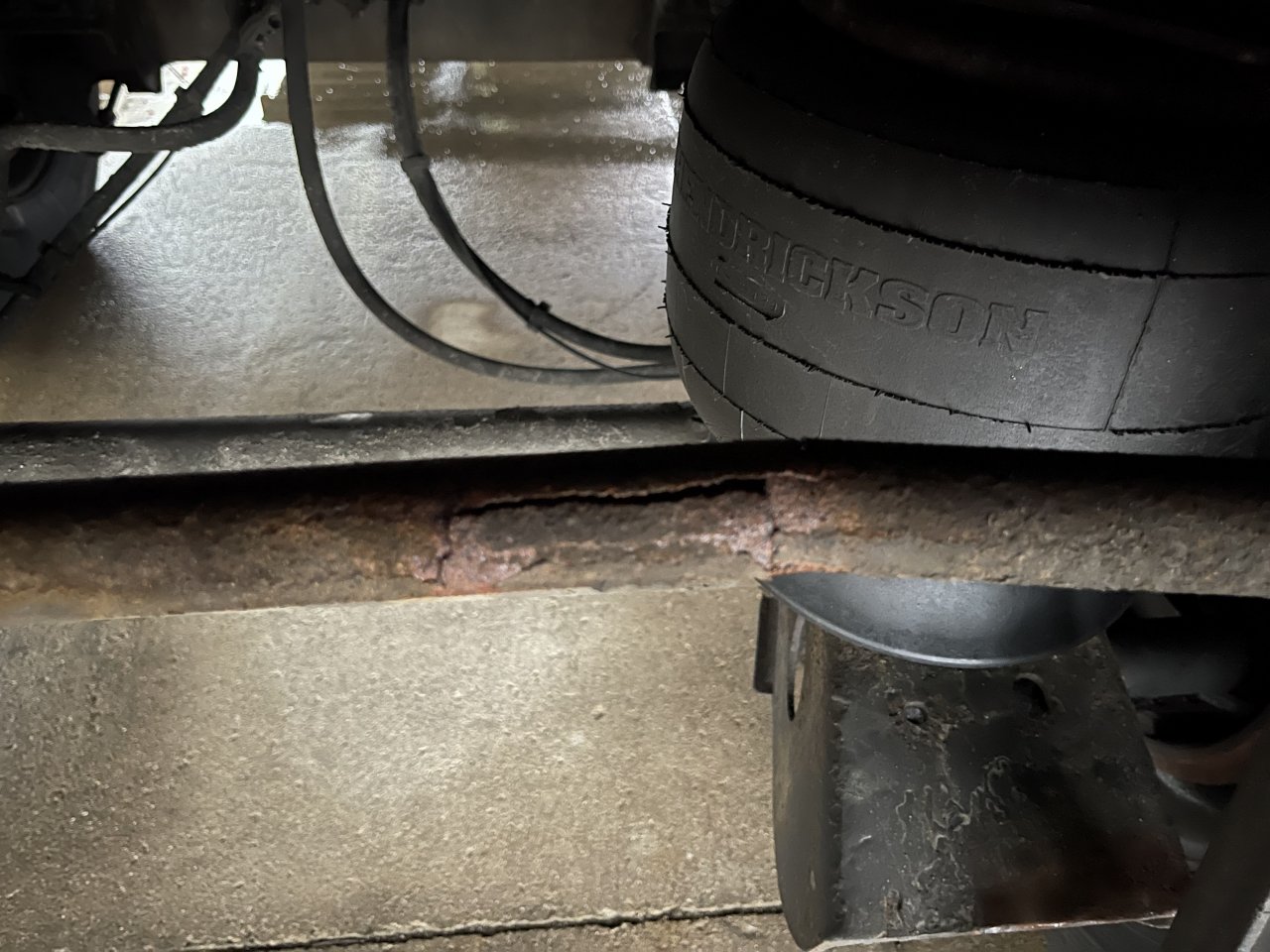

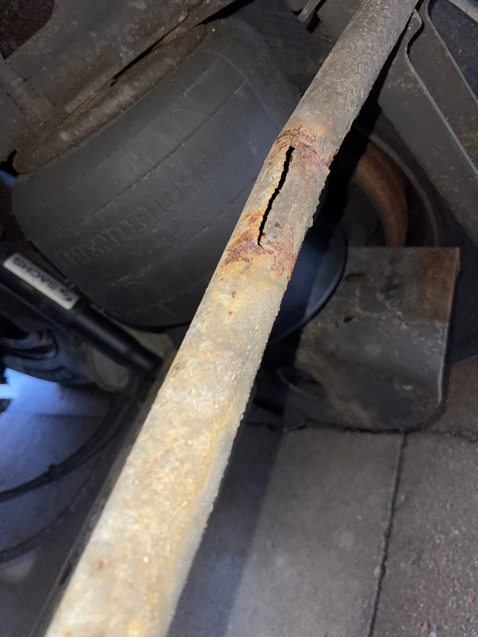

    Hello guys. I have 2011 wabash trailer dry van. Does anyone know how can i remove those Surelock support arm on the back of the trailer ? I don’t know how to call it but the arm or the pipe is broken. here is pic.
    please let me know if someone can help

    One side should be two bolts,spring and mounting plate. The other side is the same, but you also have to unbolt the air bag.
    You can cut back to good pipe,then slide a slightly larger pipe over and put a bolt through each side to mend it.

    Thank you for your response, unfortunately today I lost one of the arm springs it broke on half lol. What i did was i took it off and bought 3/8 quick connect fitting with locking cap.

    You might be able to find the same assembly at a salvage yard. You’ll need to measure the legs,I think there were two different lengths.
