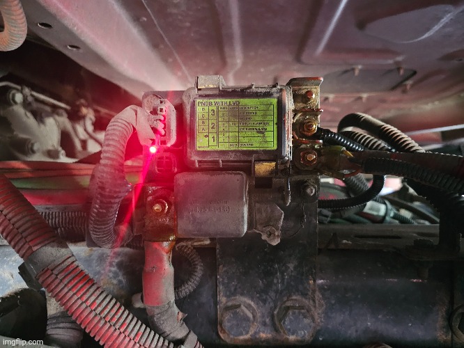

    this one I got lucky cause 1. you can see it, and 2. just lost hill start assist and ABS, +check trans light and red traction triangle.
    any copper + any moisture that doesn't get sealed/covered/coated with dielectric grease will at some point just turn into dust and let go. anything intermittent that seems to have a mind of its own is an electrical connection on its last leg.
    electrical deterioration and air leaks are #1 and #2 gremlins, air leaks you just spray soapy water on stuff and look for bubbles. isolating electrical problems that aren't blatantly obvious (intermittent, buried) you have to become a gd doctor to learn the whole system to be able to isolate what-is-doing-what under what-specific-conditions and when, otherwise you just throw $$$$$$ at it replacing stuff.
    por ejemplo...the bunk light switch cluster in my Cascadia is powered by and ran through the hazard light cluster on the dash, hazard light cluster connected to god knows what inside the leaky-windshield server cabinet that is behind the dash board. (just look up behind the pedals). the AC vent in the bunk is right above the bunk light switch cluster. condensation from the AC corroded and shorted out one of the bunk light switches, which ran through the hazard light switch cluster on the dash and shorted out the engine brake and turned the dashboard into a non functional Christmas light show. the only reason I found that is because of this video
    all electrical faults can be mitigated from the start with proper install of wire routing, wire armor, and connections completely sealed with dielectric grease. if it's coated in grease no moisture can get to it, wires and connections will last decades and not skip a beat, until one little molecule of water gets in and rust jacks the copper open with green stuff, it opens up a wound for more, even humidity, and then it's just a time bomb waiting for you on some freezing az bfe road on a friday
