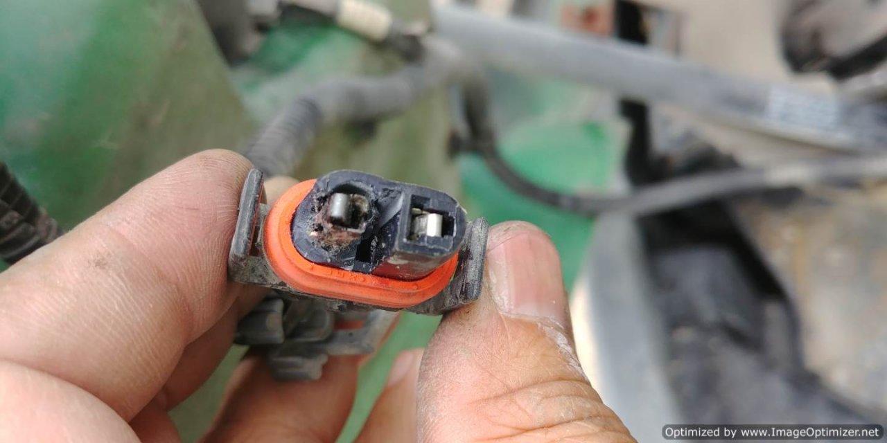

    Finally have time today to fix this problem, it turns out to be one of the pins in the bulb connector. The bulb connector looks fine at first until I start to pin test the circuits, while trying to insert a T-pin test probe next to the pins in the connector a piece of plastic around the pin broke off. I know immediately the pin was overheated and the plastic around it got brittled, break some more of the plastic around the pin and see it's all blacken.
    Autozoo as well as O'Reilly have the H11 bulb socket pigtail made by Dorman, there are 2 different parts available one with high temperature part number 84401. Two heat-shrink crimp wire connectors and it's working again, better than from the factory.

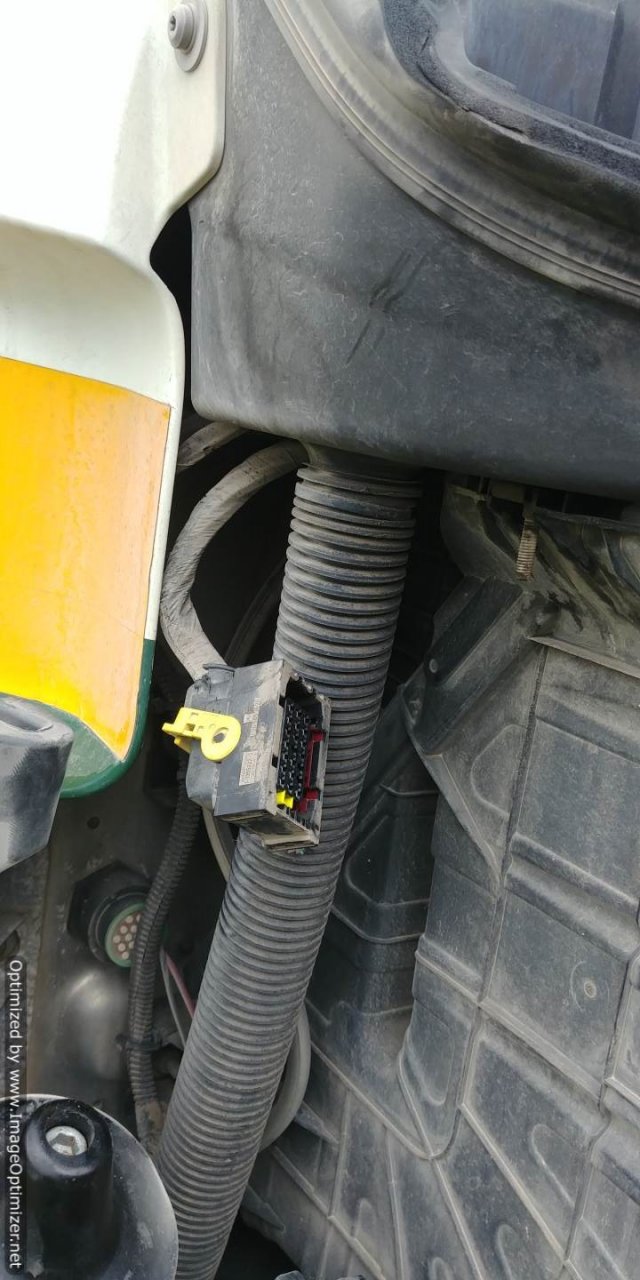

    For those who run into this problem in the future, the SAM CAB connector X18 pin 5 & 7 provide power and ground to the left low beam, pin 2 & 20 provide power and ground to the right low beam. The X18 connector is shown in the picture it's the one at the very corner of the SAB CAB underside.
