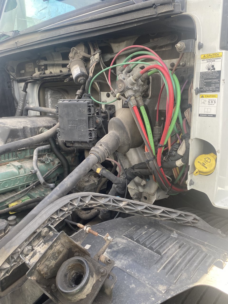

    I’ve been to 3 mechanics, one of them is a dealer (although an amateur ones on a newly opened shop didn’t do the job). None of them say a thing about clutch air line leaking. (And if it leaks it does while driving).
    Now I got pumped up about this idea “What if?”. I’ll replace the line and see where it’ll take me.

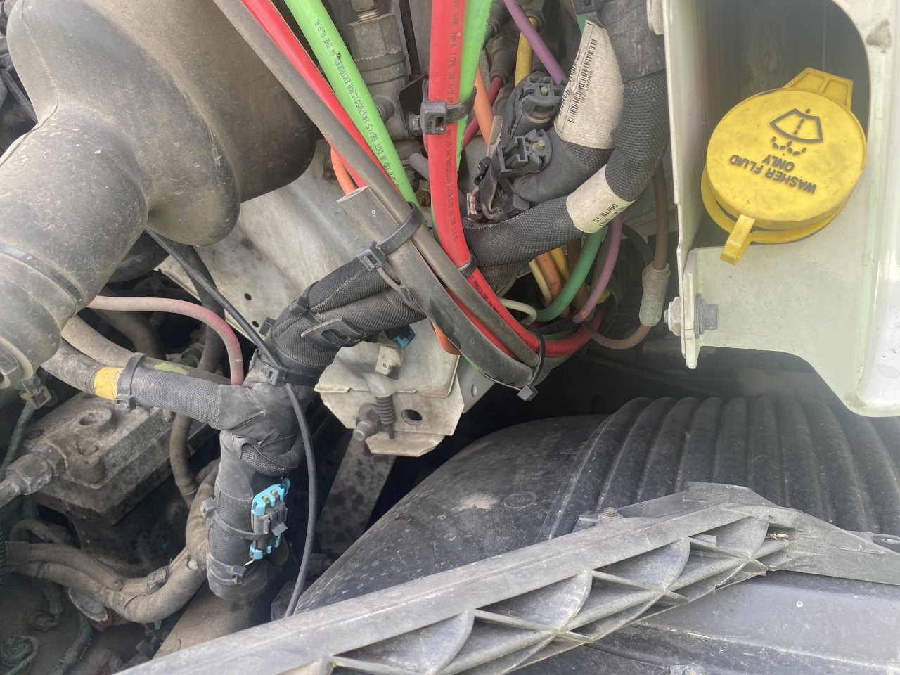

    FE317AD8-79B4-4ADA-9CF4-D29D530D6021.jpeg 273D0D34-DB46-48C0-95B7-476BD44B4CDB.jpeg

    Take it to the dealer, have them put it on the computer and either reset the governor system or have them determine what the problem is. Your truck is a typical volvo, big pia because it has too much controlled by electronics.

    I marked where your governor would’ve been, so that’s right, you don’t have one where most Volvos do. Check that fan clutch line and if it’s not it take it to a Volvo (not a dealer) mechanic.
