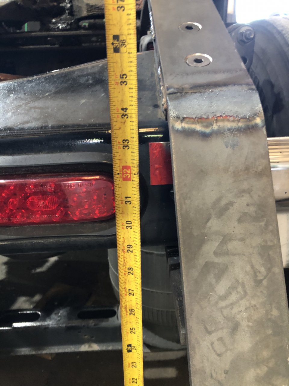

    Thank you for your advice!
    I have 34” at the starting point with inflated airbags.

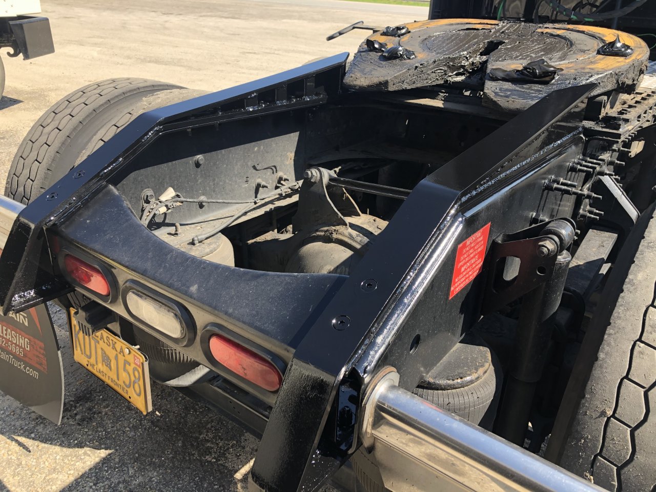

    EDD3A74D-9F1B-435D-BB92-10987873167C.jpeg F92DE039-8220-4CE6-9B3B-4467C3F5C7F4.jpeg
    Best guys in USA.
    Thank you!
    Tug Toy, Artax and Stray_Dog Thank this.
  4. AModelCat
    Joined:
    Messages:
    29,687
    Thanks Received:
    164,632
    Location:
    I like the holes drilled through the upper flange, right above the warning label saying not to do exactly that! :eek:
    RGN, Oxbow, MTN Boomer and 7 others Thank this.
  5. Joe567708
    Joe567708 Bobtail Member
    Joined:
    Jun 5, 2021
    Messages:
    36
    Thanks Received:
    62
    Per DOT certified chassis mechanic:
    On top flange, behind the the 5th wheel and on the lower flange behind the rearmost axle airbag, you can drill+G8 screw+1”washer on each side+torque at 250.
    Artax, Stray_Dog and Landincoldfire Thank this.
  6. JDHIGGINS44
    JDHIGGINS44 Light Load Member
    Joined:
    Jun 29, 2015
    Messages:
    113
    Thanks Received:
    272
    Location:
    Waynesburg, PA
    Looks like very nice work and not very prevalent need in our area due to 95% of lowboys being hydraulic, but I personally do not care for the plates bolted like that behind the fifth wheel, looks like a catching SOB if you miss a trailer just a bit or have to try and get back under a trailer that was dropped too low, but that's just my $.02
    Joe567708 Thanks this.
  7. nikmirbre
    nikmirbre Road Train Member
    Joined:
    Jul 27, 2011
    Messages:
    5,584
    Thanks Received:
    10,337
    Location:
    High Point NC
    0DDE46B2-018B-4120-8926-29EF2075C82D.jpeg 1DF9D1C7-769F-4D1D-BEF0-D9040142E467.jpeg This is what they looked like on my other truck.
    JDHIGGINS44, Stray_Dog and Joe567708 Thank this.
