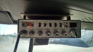

    Just to show you that unless your radio draws almost nothing,ciggy lighter socket aint the best plan..

    Just a piece of alum i found at the shop..Cleaned it,cut the corners off it so i dont stab myself in the head,paint n clear coat..Mount it the the liter lips are wide enough to angle the radio dials n screen at me..Dont wanna scratch the inside of the truck so ill also get a few of those lil felt pads that go under chair legs...When i move outta the truck4 bolts and done..

    depends on how many amps that export radio draws as to weather you can run it off a cigarette lighter plug or it needs to run direct off the batteries.the bigger radios draw more amps to run them......
