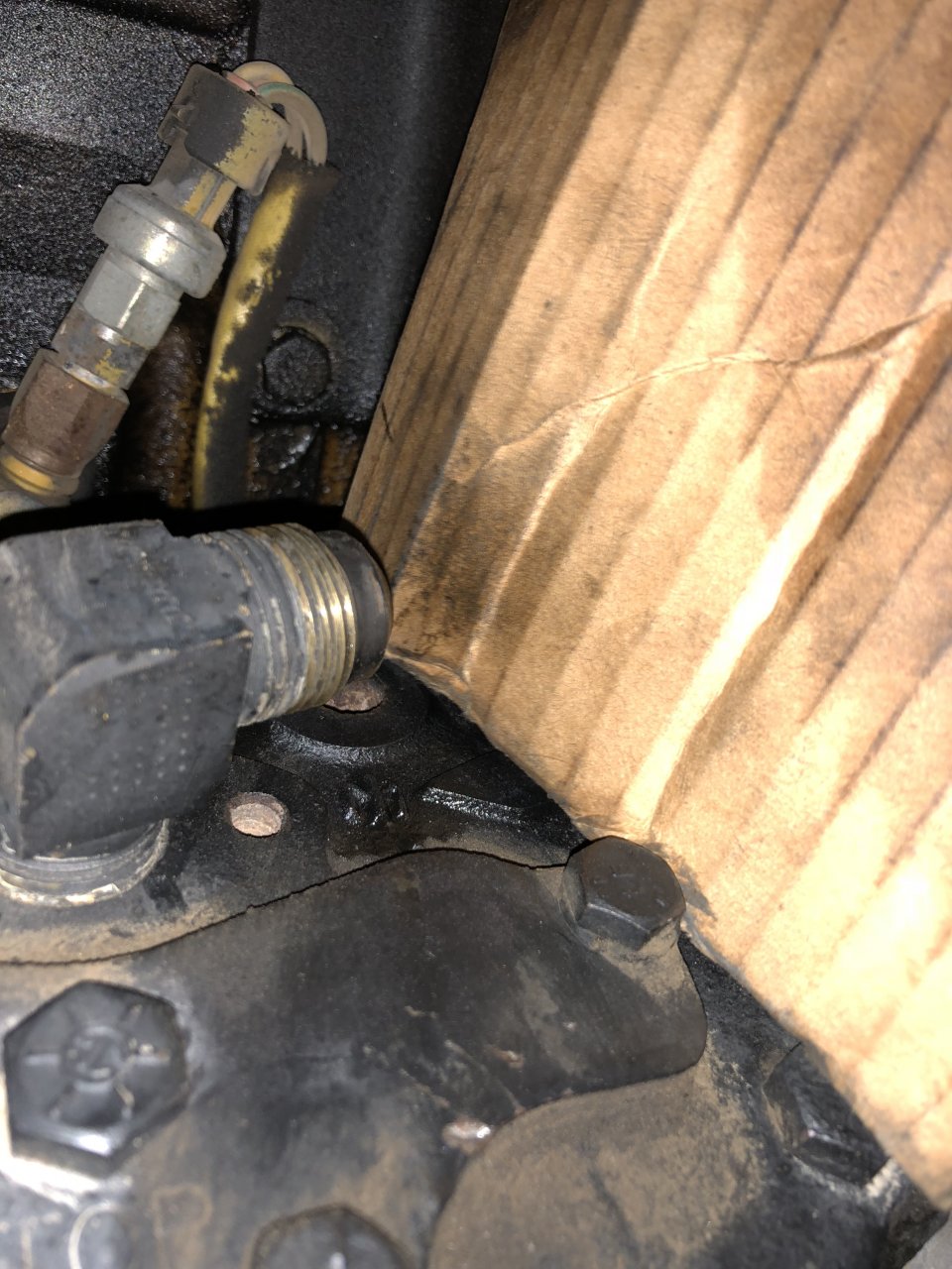

    Do the test I stated in my first post with the engine and compressor at operating temp. This test will show if the compressor is passing oil or not.

    So with intake off and engine at opp temp, it shot oil like a splatter then it stoped . Did it three times with in 10 min . Not a lot

    Can you post a pic of oil splatter on a piece of paper?

    Two big stains

    After five min

    . It splattered couple times like a lot then stoped then splattered again. It was wierd but then stoped and that pic I posted up top is after all that

    From what I see it doesn't look bad. Is the inside of intake tube wet?

    Yea just a little . It ussually has a leak at that elbow piece on the intake side u can’t see it because o wiped it . But with that disconnected it was splattering a good amount but just did it like twice .
    The line that comes out of governer is all covered in oil . My air drier all covered as well. And my tanks drains oil for about 3 second but it’s tick like if I wiped it off dipstick . If it’s coming from engine what am I looking at ??

    That explains all the blow by and oil consumption right? Or I heard compressor can cause those symptoms as well. I didn’t think engine was problem last guy I bought it said it been rebuild not to long ago. Like I said engine consumption and blow by occurred from one week to another
