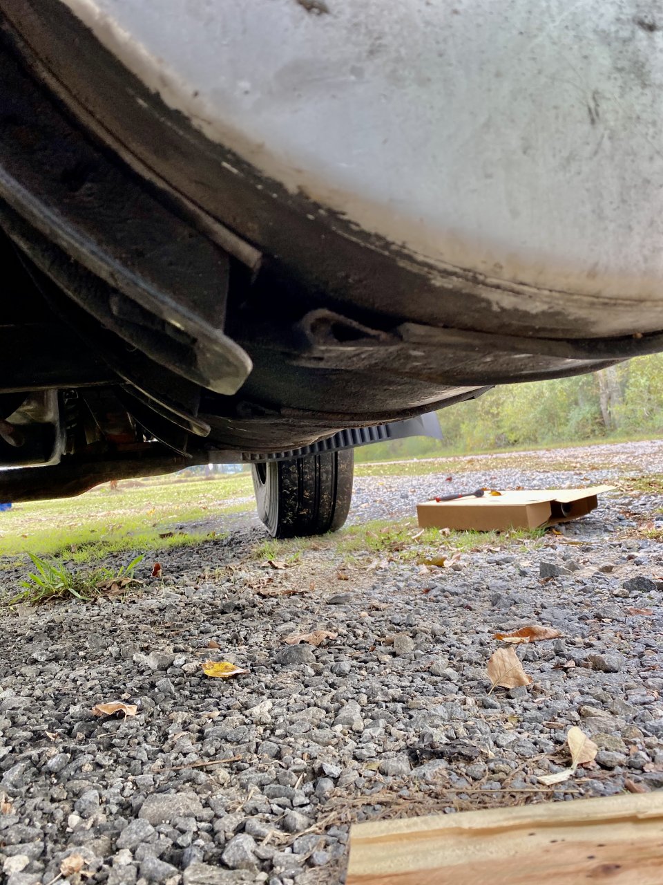

    The bottom looks like this. The j brackets stop about 8” for the bottom BFC68708-3F40-4483-96FF-5191D221F0DA.jpeg
  6. AModelCat
    Joined:
    Messages:
    29,236
    Thanks Received:
    159,570
    Location:
    I typically pump out the tank and put a floor jack and block of wood under the tank to support its empty weight. Then slack off the straps enough to turn the tank. I would leave the straps on for safety. Obviously don't put yourself in a position where you could get pinched. Change your sensor, rotate the tank back and torque down the straps.
  7. 062
    062 Road Train Member
    Joined:
    Oct 20, 2013
    Messages:
    6,226
    Thanks Received:
    33,480
    Not until you get some weight out of the tank.

  8. Dino soar
    Dino soar Road Train Member
    Joined:
    Dec 8, 2017
    Messages:
    4,791
    Thanks Received:
    26,878
    I would close it up and take a load somewhere and burn some fuel.
    Make sure you don't run out but try to come back with as little left as you can and then you'll have to siphon it into something. Some tanks have a drain plug on the very bottom of them.
    Then do like a model said. You may have to remove those back fuel lines to be able to rotate far enough.
    Oxbow, starmac and HopeOverMope Thank this.
