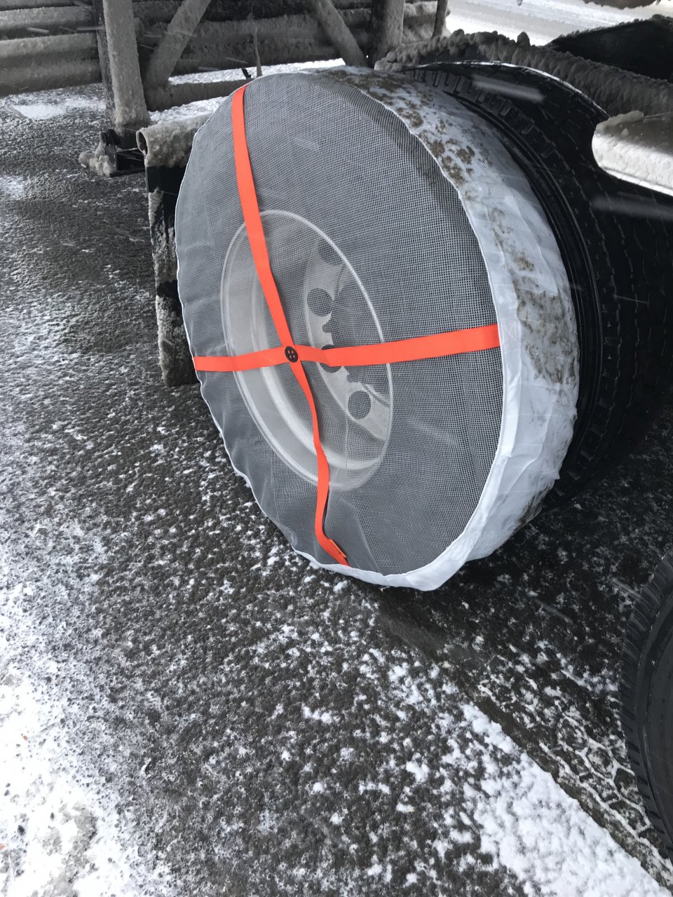

    People told me these don’t work either. Worked just fine for me. Now that being said I don’t go to the Rockies often and don’t want to carry rusty old chains around all winter. 0153584A-FC24-4258-ABD7-BB4D3F506067.jpeg

    I'm not sold on the auto chains at all. I like the tire socks though.
