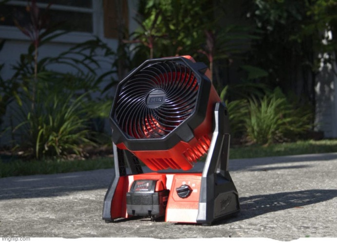

    cold air sinks, heat rises, cold air comes out the bottom so it can accumulate from low to high and push out the heat. if they shot it out the top directly you would lose 20 degrees by the time it mixed. all you need is a little fan to get the cold air up high, I use this one, it can swivel point straight up or set on a bucket right at bed height, about the size of a basketball
