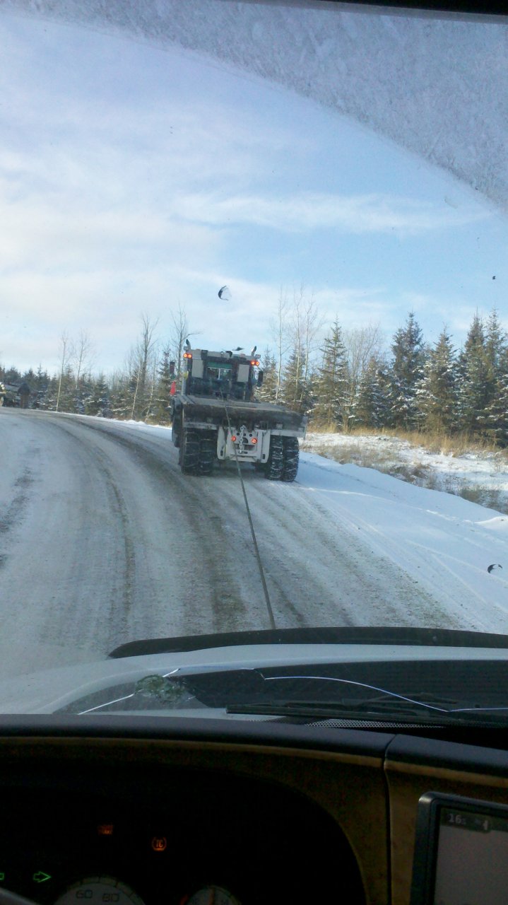

    Lots over the years, most often completely unavoidable or even on purpose--chain up, drive until you get stuck and then a bed truck or dozer pulls you through. Over 130,000 lbs in the two cases below.
    My preference, in order, is; synthetic cable, steel cable, strap, chain. I often carried all of the last three. Be careful with straps because you can add an element of "spring". If you know what you're doing you can use that to your advantage, if not, you get the results in the fourth picture...
