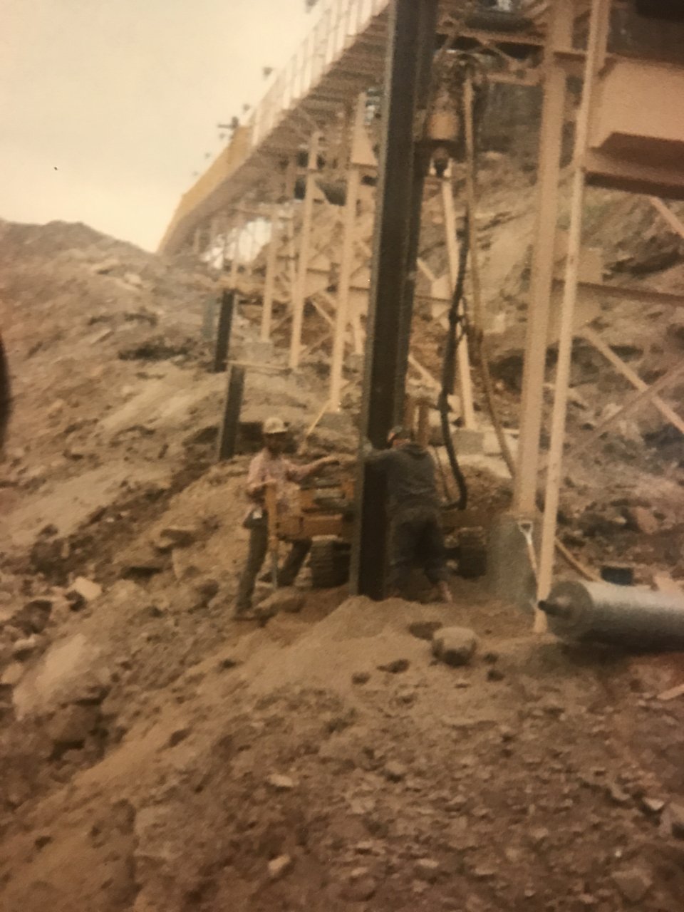

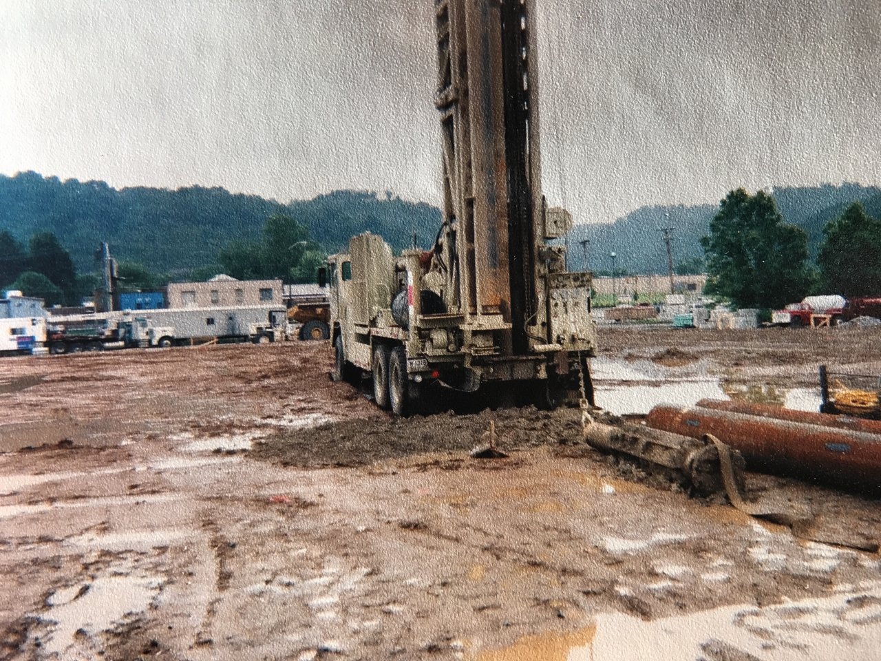

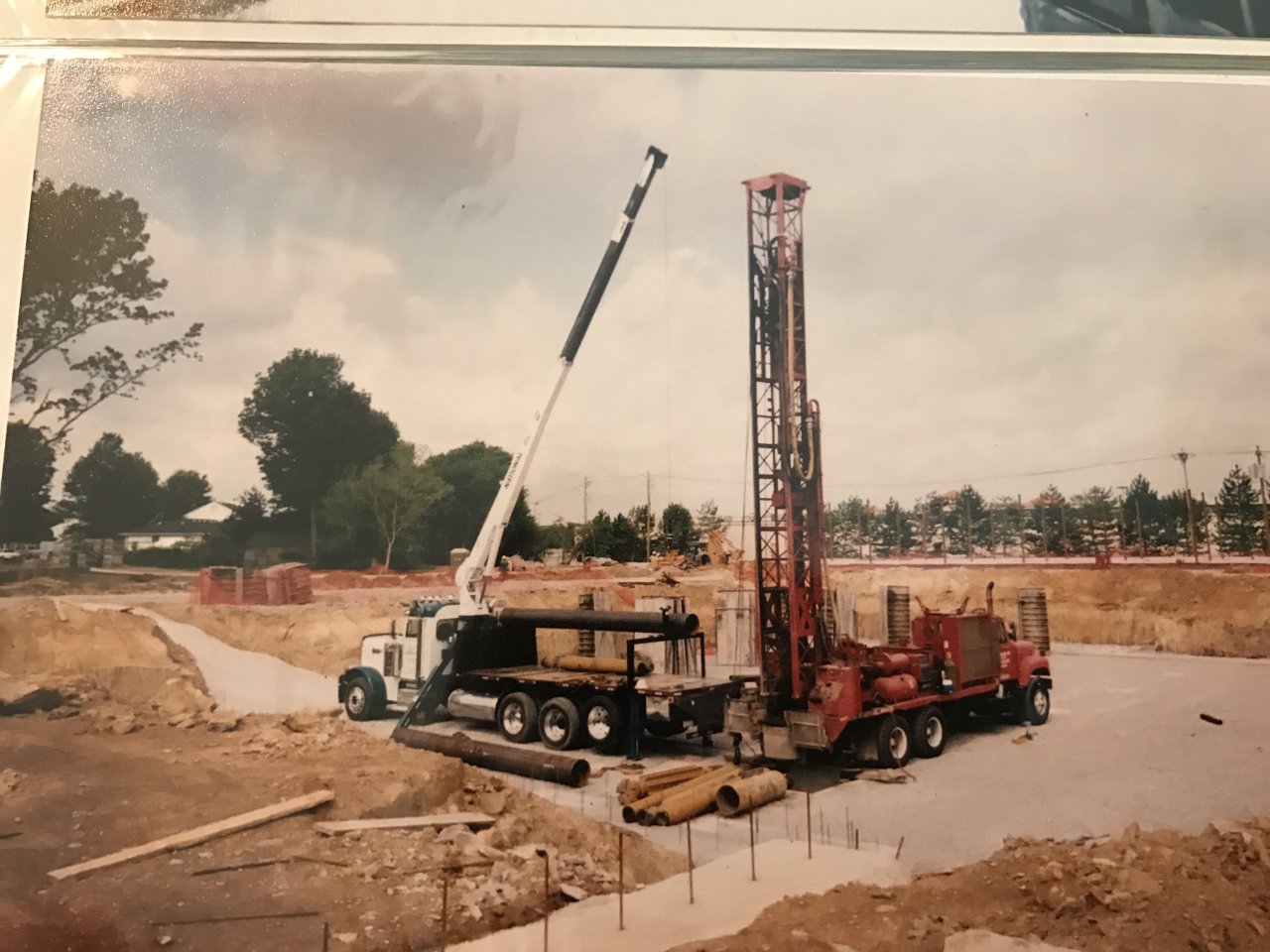

    BAFFB744-9DBE-469F-A0DB-39A07E2F28AE.jpeg F103A542-A141-4DDD-8D57-97C185DA1272.jpeg 60463E37-673C-47A7-AB6A-C18554FA88A3.png 1C98D332-F9E4-4CC9-8FB1-AE396D10919E.jpeg F53E1294-1DAB-4EEA-9592-5B005F83B59F.png FC22272E-C1EB-4324-A277-9E0D89C11B76.jpeg 7D13CEE9-15D6-45E4-A850-30183A76E0E5.jpeg I grew up in the water well drilling business. Ran a lot of different machines over the years. Just curious what Rig he had.....???
    The red Ingersoll Rand TH-55 had a 6V82TA in the truck originally that powered the rig as well as the truck. I pulled the Detroit and planted a Cummins 400 from a donor international truck. Never a problem.
    These drills are like a marine application in a sense, lot of constant power consumed by the rig.

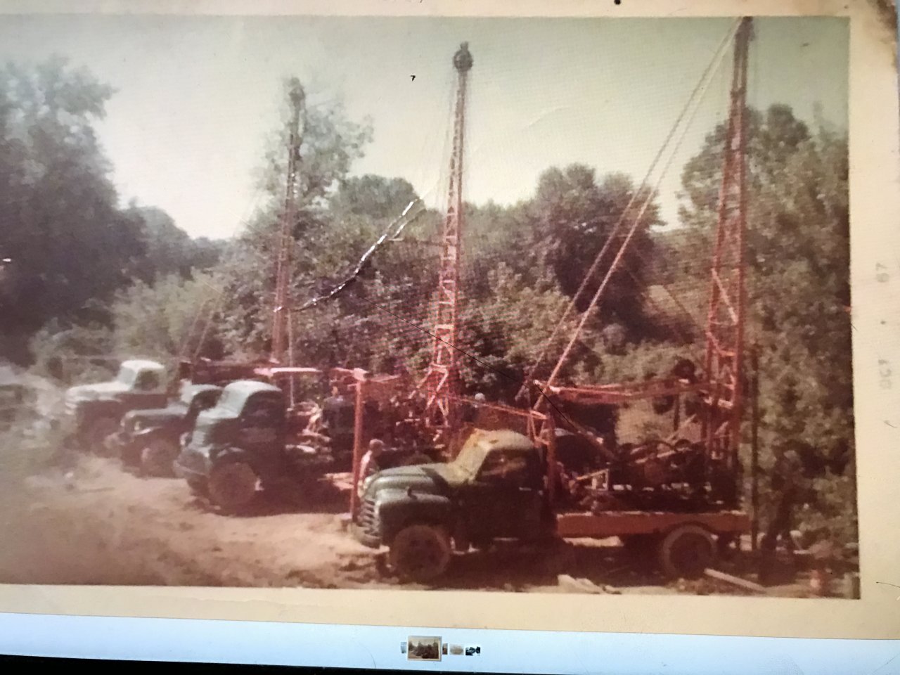

    My grand father ( my moms dad) was a water well driller in Flemington NJ. He got out of the seabees after ww2 ended and bought a Mack mounted rig. Had 3 trucks by the time he retired and sold out in ‘75. I don’t have any pictures of that side of the family but one somewhere of him standing behind the rig on a location while drilling. I’ve been told they were Macks but my mom thinks she remembers one of them being a White.
