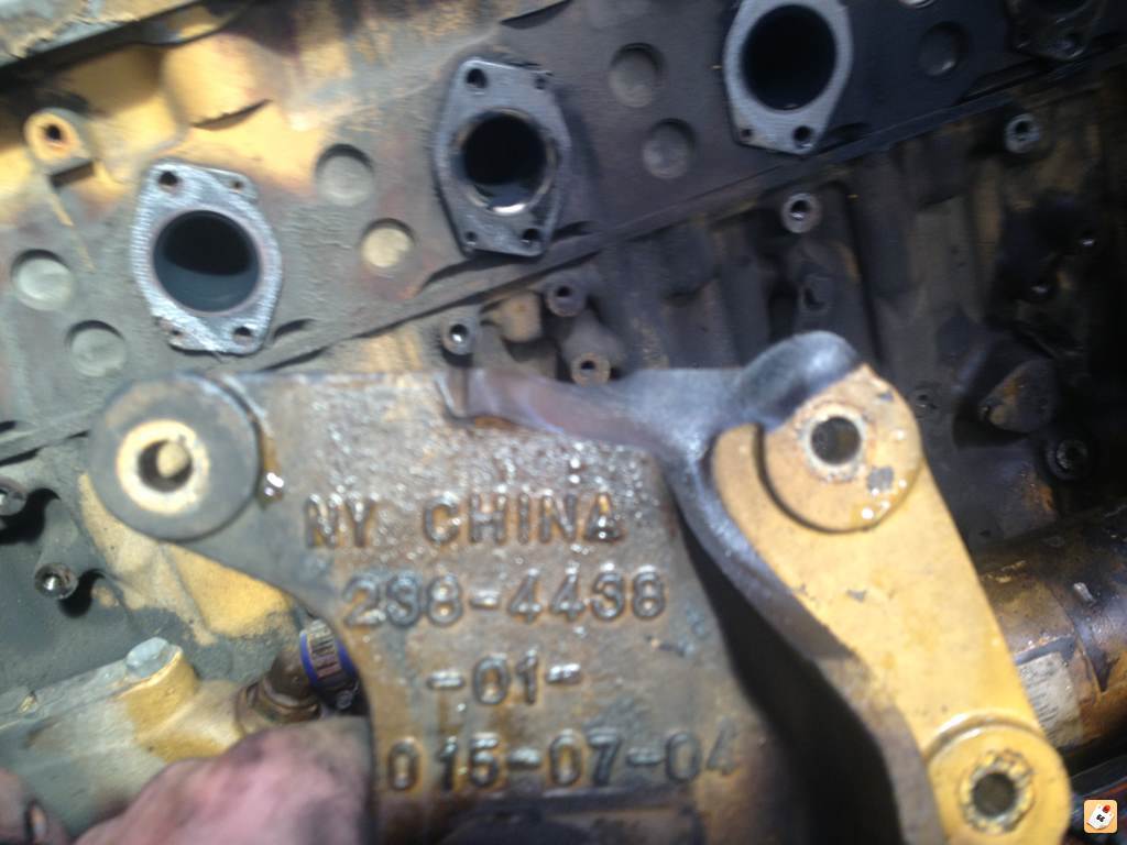

    Here is a new one for you all. Upon heading into no mans land to do a broken manifold stud on an acert, I found the pre cooler mounting bracket was broken at the top. You will see the word CHINA clearly stamped on it. The pre cooler was not flopping around at all and would not have known about this without pulling it down.

    What is the world coming to. Never noticed china before.

    I've replaced well over a dozen of those (not on the same rig, but amoungst a fleet of cats), super common to break.
