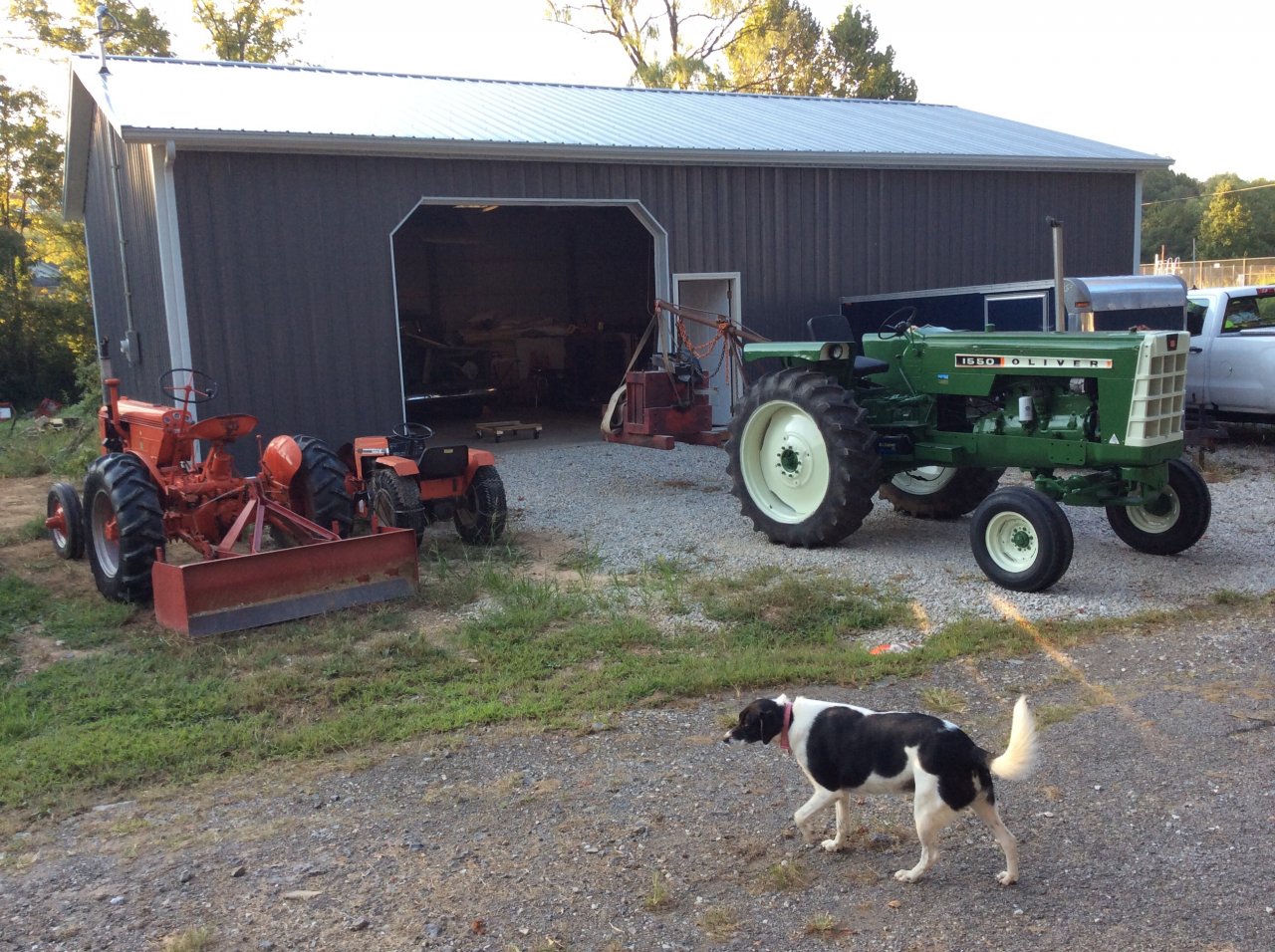

  10. OLDSKOOLERnWV
    Joined:
    Messages:
    19,301
    Thanks Received:
    291,804
    Location:
    @tucker thought I had a better pic, Wish it was taller, and insulation was finished lol. But I'm grateful for what I have. Needs to be twice as big, can't Woop a cat in it without getting hair all over ya lol. To much stuff in it.
