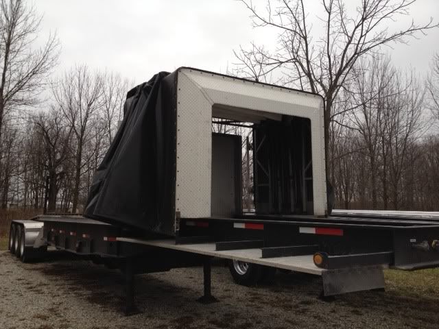

    The TarpStop system isn't bad. It's got a few issues that I would change but the system I have is totally custom and they did an awesome job fabbing it up.

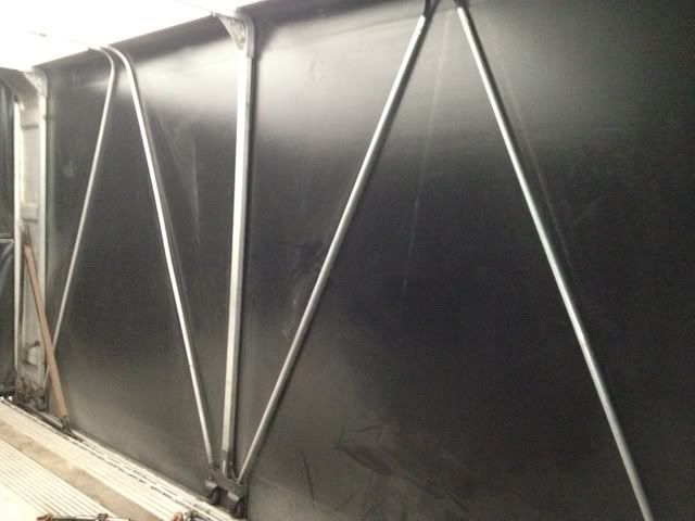

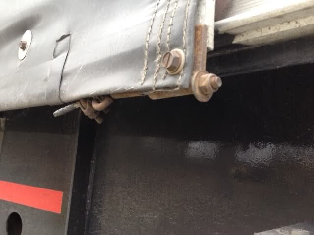

    Here's the cables on the bottom I don't like

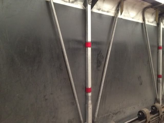

    Here's the tarp held to the cars with velcro (now they offer a sectional tarp which probably does away with this)

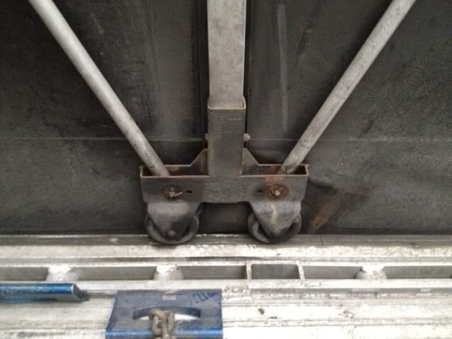

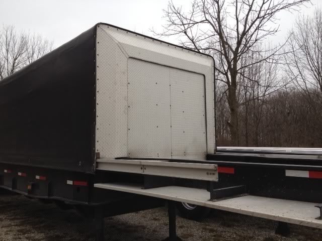

    IMO I think the track should be flipped over so the guide wheels are underneath like most of the other brands. It isn't an issue with this coil trailer because it's never loaded with a forklift. But I think if someone was trying to haul lumber or pallets a fork could do severe damage to the top "U" piece. If it was crushed the guide wheels wouldn't pass.
    And here's the final complaint which I'm sure they would leave off. I bought this trailer used so I didn't have a choice. Unless your going to pay me for the advertisement, please leave it off.
    Other than those things they did a great job, especially building the 2-piece bulkhead so the tarp can roll beyond it.
