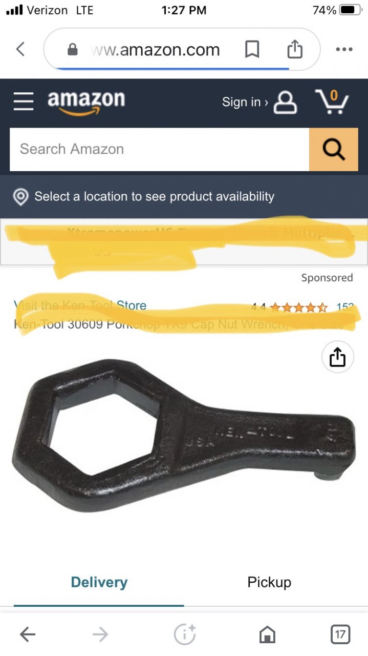

    We call them a Budd Bar. I don't know what their actual name is but if you sent one of the crew to get one they all knew what you were asking for.
    They're great as long as they don't get wallowed out and even then you can shim them a little with pieces of sardine can. Past a certain point, just throw them in a canyon for the archeologists to find someday.

    I watched a man with a Kodiak service truck and pto driven compressor when his company issued him a set of those. The compressor was set at 200 LBS plus with a 1 inch hose to the gun. He had them on some big machine and wide open on the gun. They were snapping like tooth picks while he was laughing and throwing them back in the box for management.
    They have their place but it is not with that guy. He could however put a tire on a 950 Cat loader by himself.

    Had an idiot in the shop try to hold one of those with his hand while using an impact, it didn't end well....
