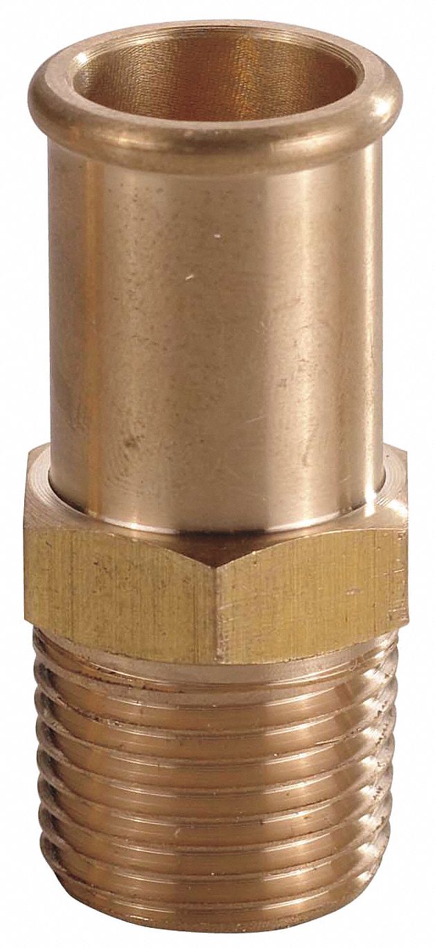

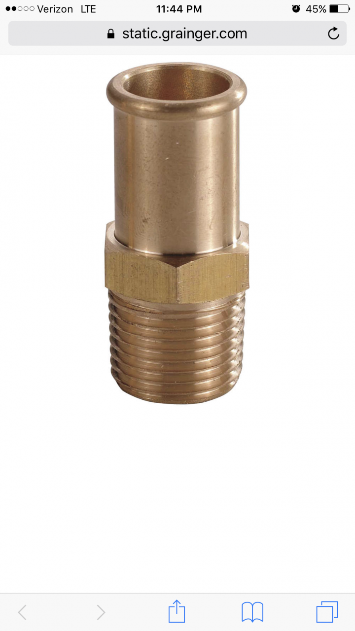

    My crystal ball says they are 1/2 male pipe to hose fittings needed. Those fittings are usually smooth with a hump at the end. Barbs have multiple humps which would work also but not the norm in heater hoses.
    Do away with two fittings under the hoses and use one. The hoses look to be 5/8's. If a 5/8 open end wrench will fit over the tube ,a little loose, where the top of the hose connects they are 5/8. If it won't they are 3/4.
    Over sized clamps have a longer area at the worm gear. This can cause them to be unable to conform to the smaller circle and leak, as mentioned.
    The blue hose is a superior silicon hose but they are softer and require a special clamp. They have an inner band inside the clamp that prevents pushing part of the hose through the slots in the clamp. This happens over time loosening the clamp and then leak.
    Who ever thought so much could be said about a couple of heater hoses?
    By the way it is marked on the ball valve, 1/2. Thanks Grape! I see that took me 30 minutes.

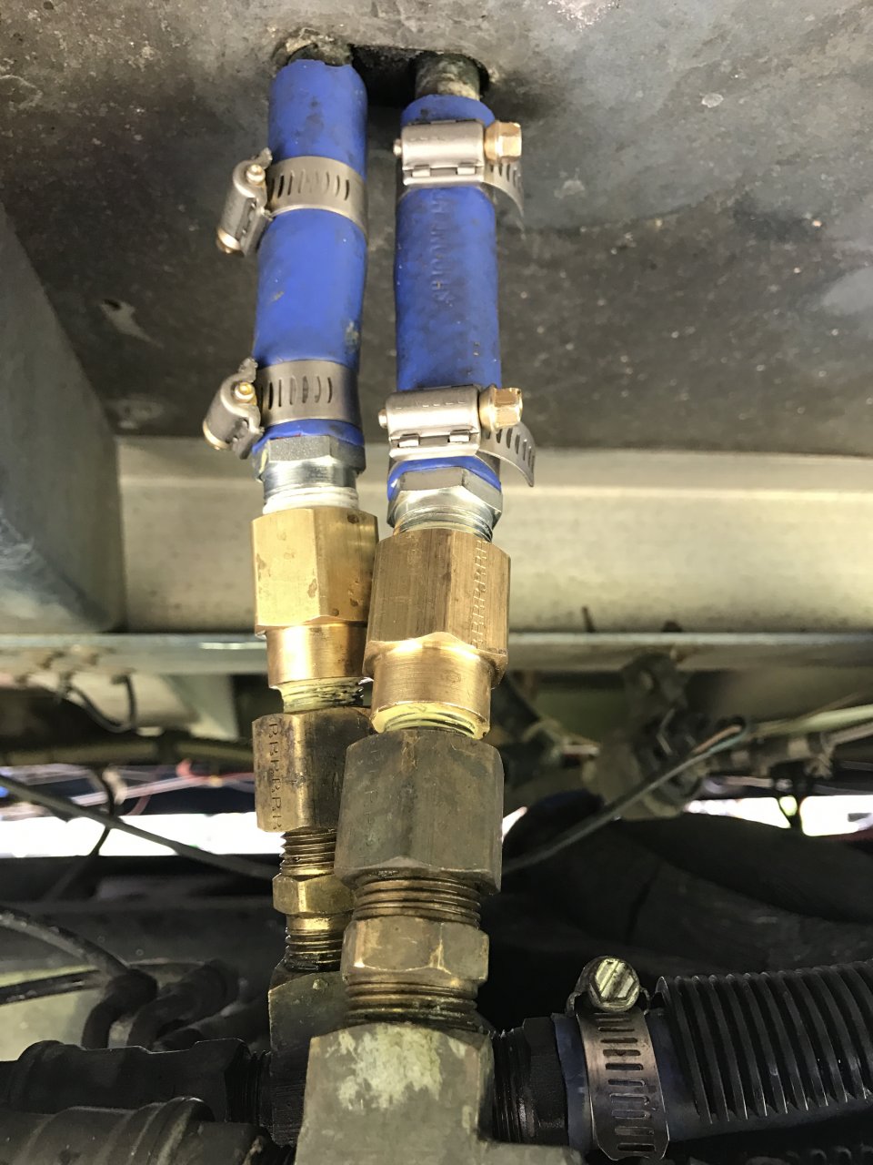

    Yeah I like that suggestion grapeApe, I didn't want to fool with trying to loosen those double ended thread pieces and damage one of my other lines. But I think that's the best solution paired with the right clamps. Now, I got some good gooey pipe dope or teflon tape, which would be preferable to use on the new pieces I install? My gut is telling me the pipe dope.
    Time to drain my coolant Friday, into clean buckets. Because trying to crimp my lines seem to never work for me.

    IMG_0813.PNG IMG_1001.JPG Finally got around to fixing... thanks grapeape, boxcarkidd and the crew
    I got a coupler piece, then put a 5/8 pipe nipple attachment with a flange, also i got better clamps that are smooth on the inside

    That's a lot better than clamping onto a pipe nipple. Personally, I would have found pipe nipples to screw right into those tee's and used longer hoses to eliminate 6 fittings. The simpler the better, more fittings only means more potential leaks, but what you have there should work just fine as long as all those fitting are sealed up good.

    Yup, No doubt... i tried taking those fitiings out of the T, and those were some tight fittings... i figured i would leave them in -instead- trying to break em loose, twisting and damaging another hose connected at the T... hopefully it wont bite me later for it...
    i would have rather simplified it, but i am a lot more satisfied where it is than how it was

    Those four clamps are way too tight. Something isn't right for all 4 of those connections. You need to put something on all 4 with teeth. Too hard to convert to English and describe for me.
