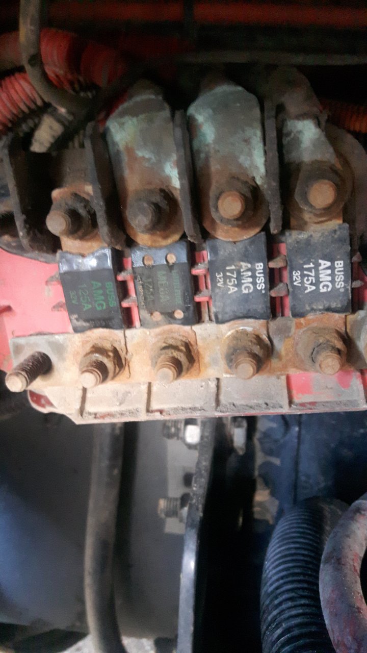

    The shop that did the inframe also added 4 hours of labor to replace all 4 batteries and clean all of the connectors. This is what the area loiks like.

    That looks horrible! Take everything off and clean with solvent and a wire brush. Then clean the solvent off with brake cleaner. Put it all back together and smear a bit of grease on the busses where the writing is (not a lot and don't get it near the connectors) spray the whole mess with red terminal protectant. Carefully wipe off grease.

    At any rate, you MegaFuseJunctionBlock looks seriously corroded. And you original BOM is spec'd with a DR 36SI 160 amp to have a sense wire hooked up to the batteries. Try disconnecting batteries and cleaning up some rust? Sounds like you might have an excessive draw somewhere?
    Here is your MFJB:

    Your MFJB is a -002. And the picture is upside down from what you took. So that seems correct if I'm reading all your fuse ratings correctly.
    Can you borrow an amp clamp and see what's pulling excessive loads?

    I can't borrow an amp clamp but will fix the Mega Fuse Block. Do you happen to know who actually makes the MFB? I want to buy another MFB like this one but with 6 fuses and add a fuse for my APU alternator and another fuse for inverter. These are wired directly to the batteries and may be why there is a huge draw on my APU alternator.
