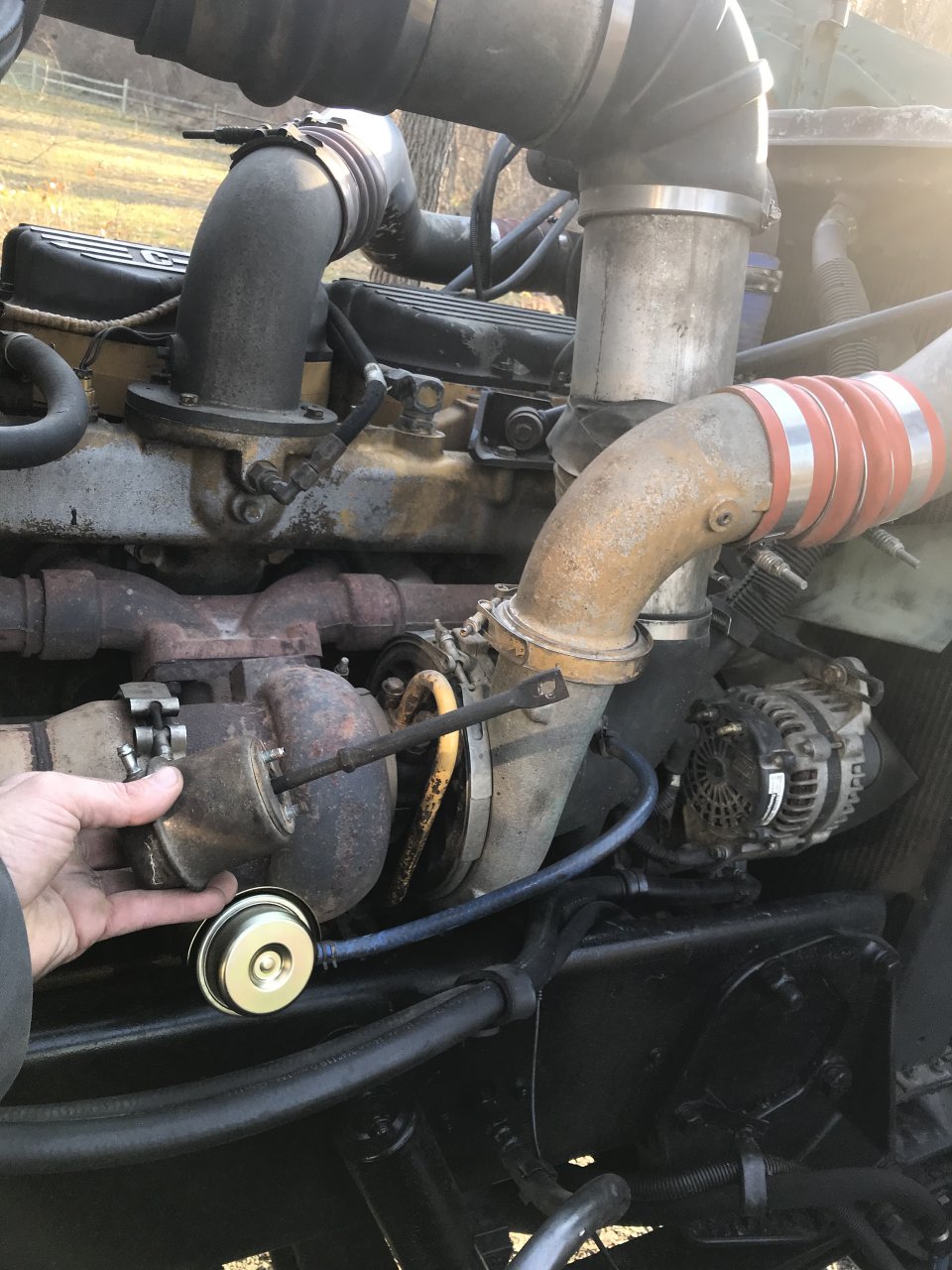

    Well I removed the actuator and the wastegate moves free as a bird. Also took exhaust pipe off to get a visual of the gate. So I just need to find a company online that can get me the actuator this week

    So is this truck gonna feel like a whole new animal when I put my new wastegate actuator on? being since I had that massive airleak coming through the diaphragm?

    Just thought I would follow up on this thread. These original equipment actuators sell for 250 bucks. The only other place I could find them is from a company called Naples turbo. They second day air ups the part for me for 10 bucks. The actuator cost like 69 bucks. This actuator Takes 2 more pounds of boost to open up. They have the specs for the original equipment. Anyhow, Upon install the next day and pulling a load up hill, truck is boosting super fast and getting steady 27 psi. Was very impressed all day. In the picture is the old one in my hand obviously and the new one installed
