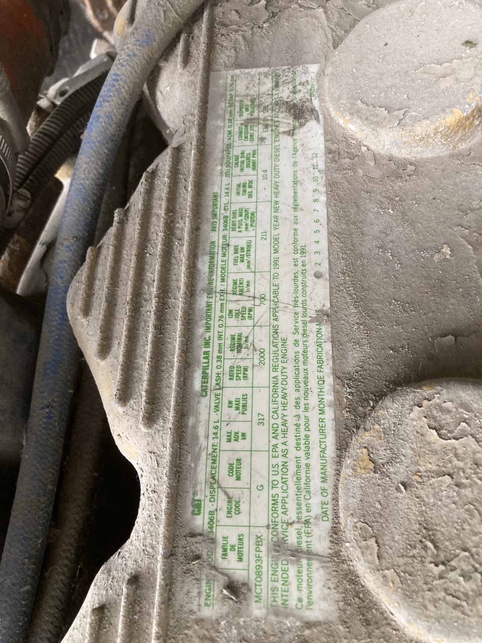

    That valve cover is going to be a 4MG or a 5KJ.
    W923, Oxbow and spsauerland Thank this.

    He said 7E5888 pump so if it’s the matching valve cover to the pump has to be 5KJ serial number

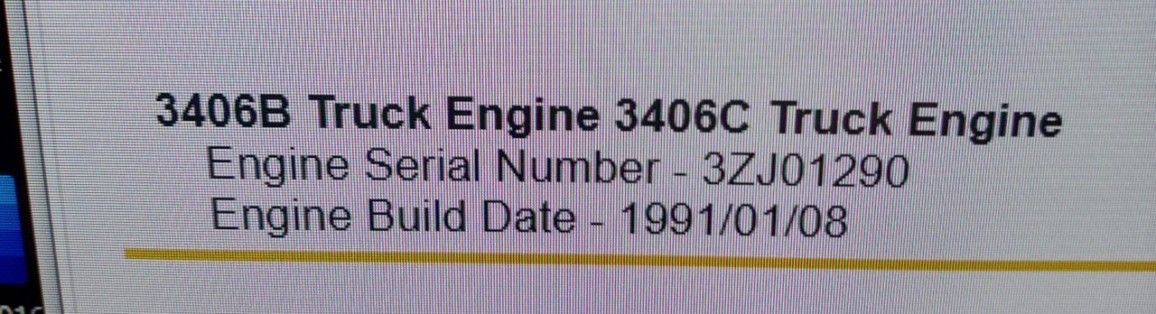

    I’m betting it’s 3ZJ01290. Probably the most common of the mechanical.

    It’s a 3zj

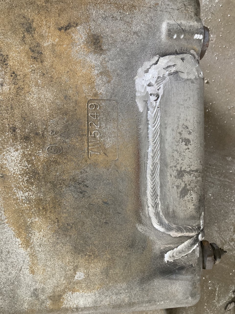

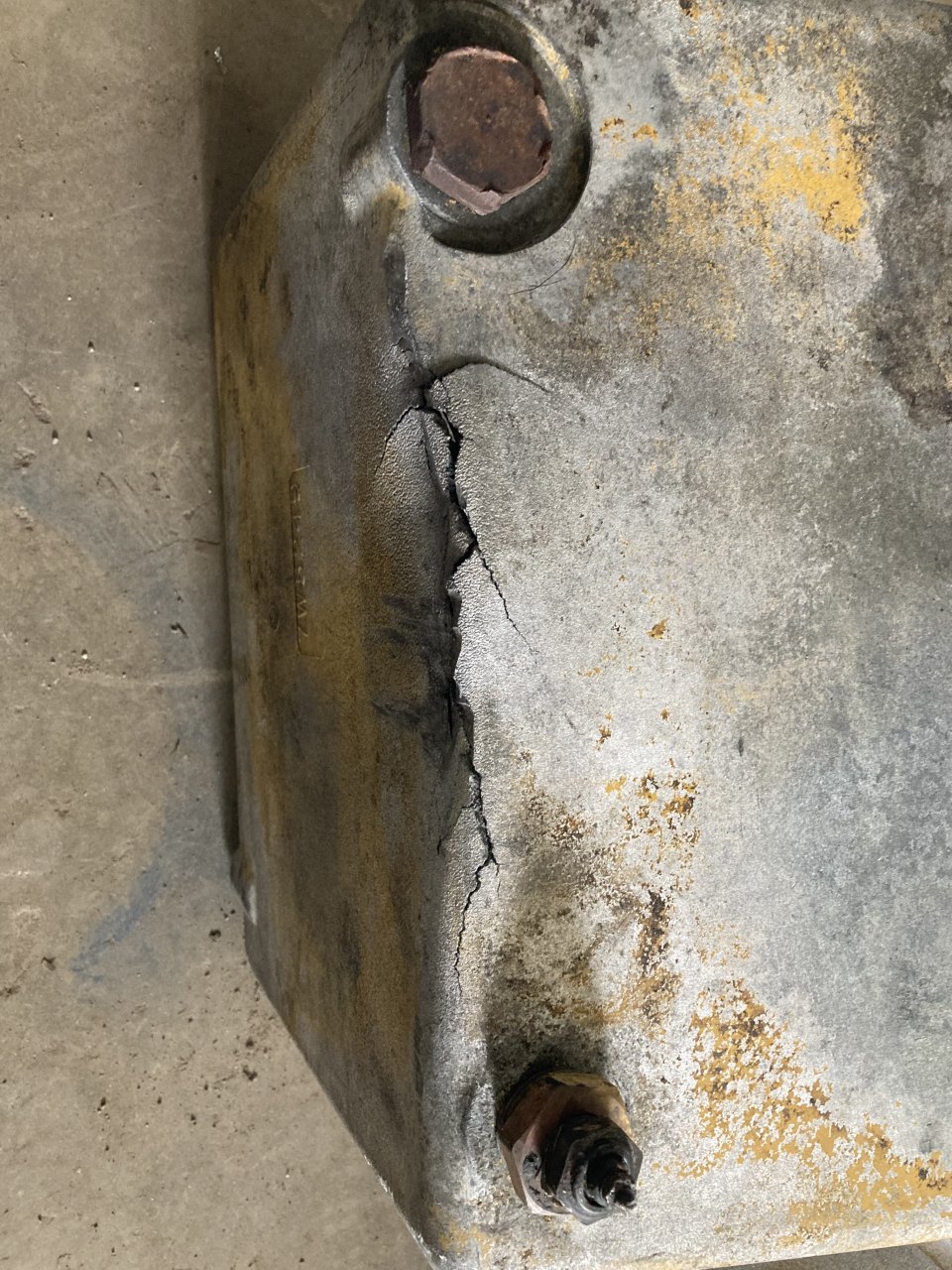

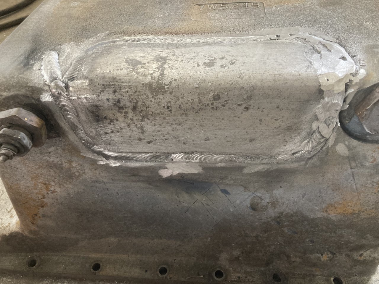

    Mistook the z for a star like it had on the other end 7559EAF0-A322-4D81-85FB-0EAA6074E22D.jpeg Grrrrrr. Guess the guy at the salvage yard hadn’t heard oil pans aren’t a lifting point
