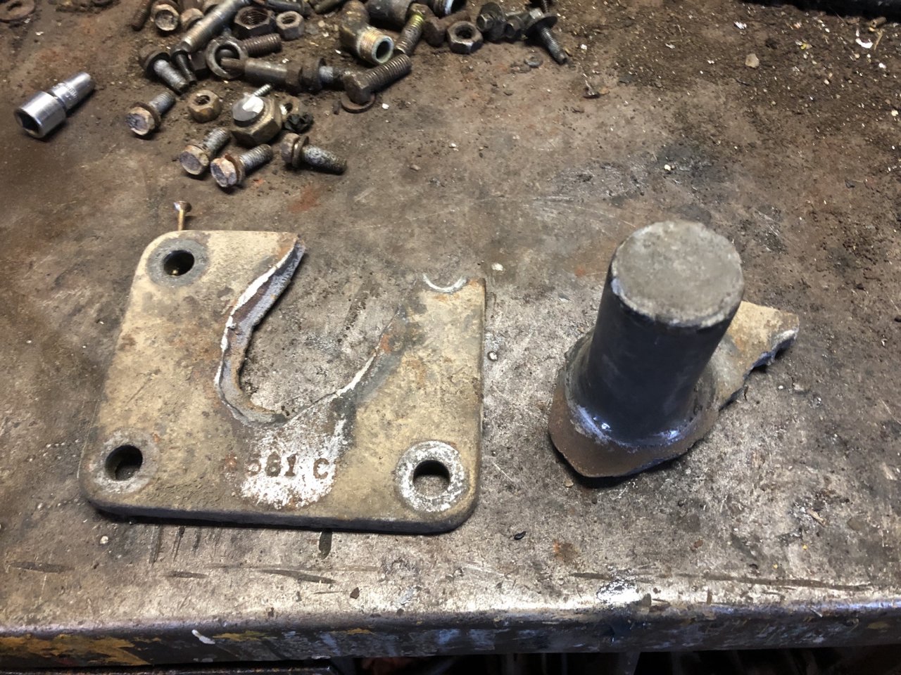

    I posted earlier about the International dump truck twisting off the input shaft to the front diff.
    The truck hauled one load since being fixed and was back at the shop....
    Driver: truck makes this awful banging noises every time I try to move it. The Clutch now doesn’t work and the shifter is in a weird position.
    Mechanic: (raised one eyebrow) hmmm. Looked underneath...
    Yup, broken engine mount.
    30 mins later, the mount is on the bench...
    Had it sent away to be welded as it’s tempered.
    Part came back later the same day after heat treatment.
    Installed the welded mount, bolted up, checked the other mounts, dropped the jack.
    Later..... Dump truck comes back.
    Driver: I hauled only one load and now the truck is doing that funky crap again. I slammed the door and had the excavator operator back the truck in as it kept stalling in reverse.
    Mechanic: (looked under the truck) yup, your passenger side engine mount broke as well. Thought it was fine before but I guess not.
    30 mins later.... mount is removed and sent away to be welded.
    After the weekend.... mount came back. Installed and the truck has been gone working since.
    Both driver and passenger mount cracked looking identical to each other.
