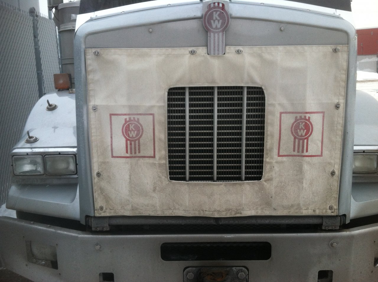

  5. AModelCat
    29,853
    166,492
    So put a winter front on and problemo solvo.
  6. Cat sdp
    Cat sdp . .
    21,349
    76,610
    Apr 8, 2012
    Orion's Belt
    Don’t leave home without it......
  7. SmallPackage
    5,916
    18,999
    Dec 20, 2019
    Marion Texas
    image.jpg Sure Don’t. It’s permanant!
    Cat sdp Thanks this.
