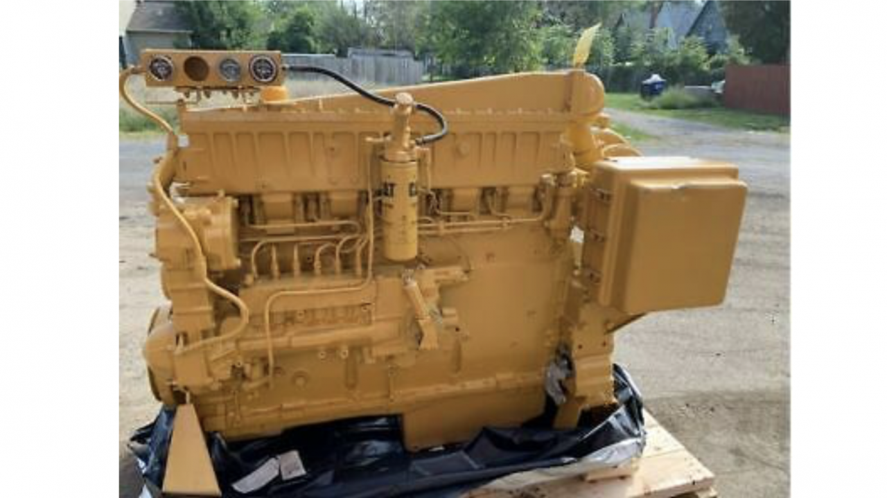

    I've owned a few 3406s and non of them had anything different than a regular cac.

    Lots of 3406's were water aftercooled, All of them up until the B models were and even they were up till maybe 87 or so. I have an 88 that is still water cooled, it is the difference between a 400 b model and a 425 b model.

    Maybe so. But every one I had was a regular old cac. I was responding to a guy that said 'a 3406 uses water cooled, I think'

    8F22FBB9-3293-4072-AB7D-3A23328C645F.png Here’s a 3406c with jwac (jacketed water aftercooler)
