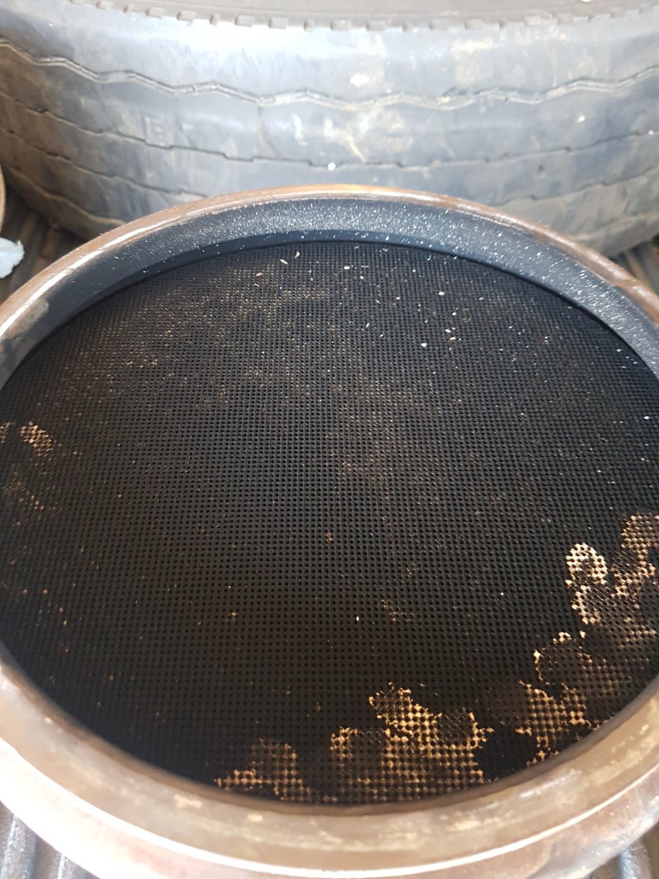

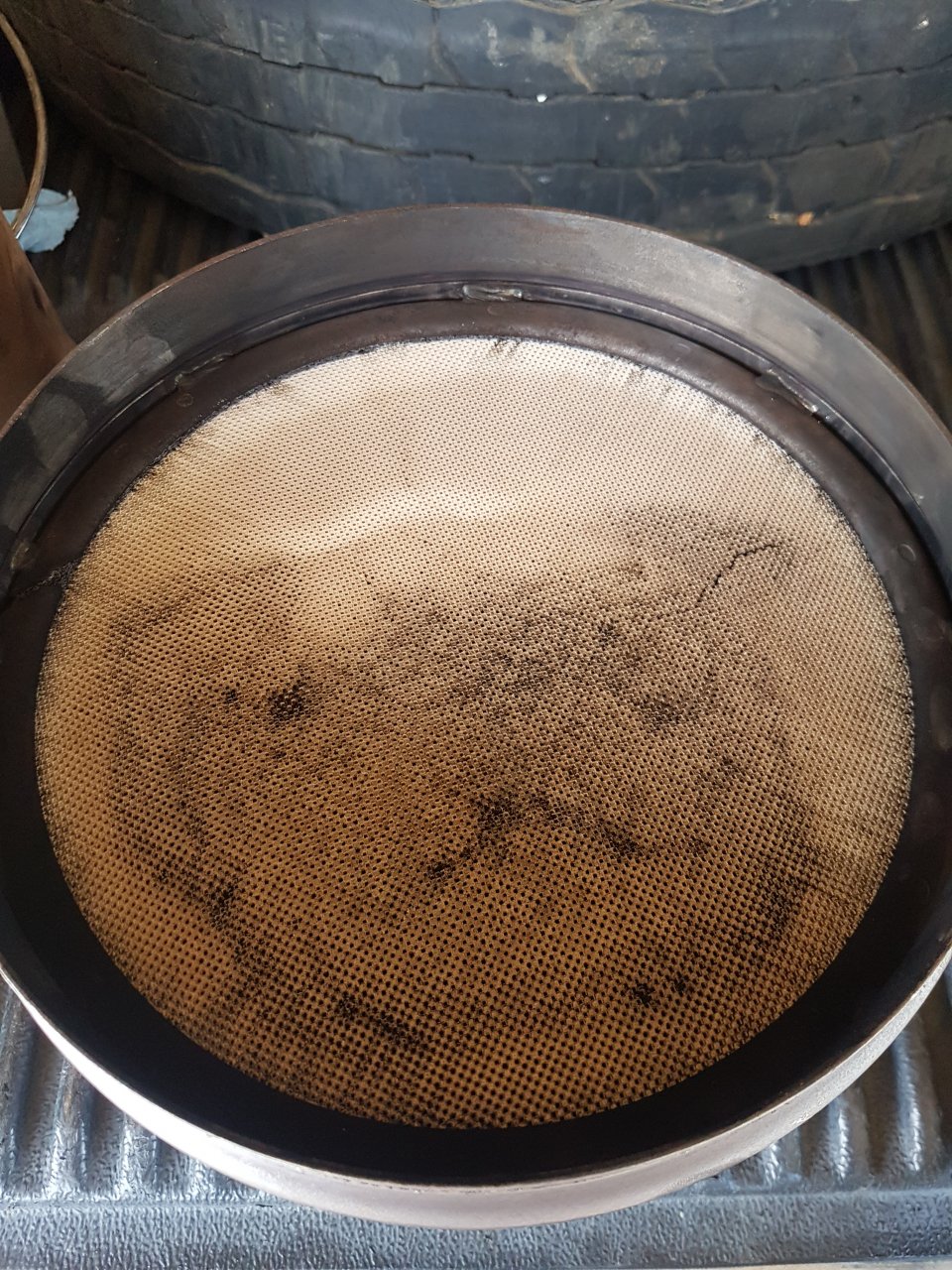

    DPF Inner Outlet side.jpg DPF outer outlet side.jpg 20180824_100105.jpg DPF Outer inlet side.jpg DPF Inner inlet side.jpg my promised pictures of mess . So dpfs were changed 1 year ago. Reliabilt remand dpfs were installed. One of them has been cracked and all soot was pushed to scr area. The truck throws low nox codes now and derates to 55mph. ####en big bill ! I guess this truck needs 1-box and 1dpf (or 2) ..This happened at 700k miles. it's 2013 Cascadia with DD15.
