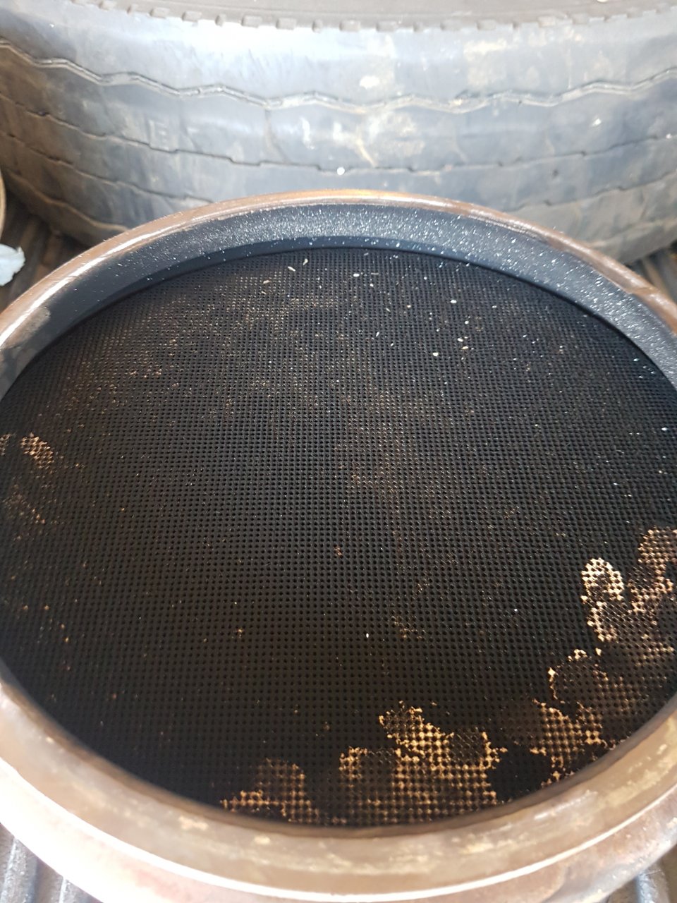

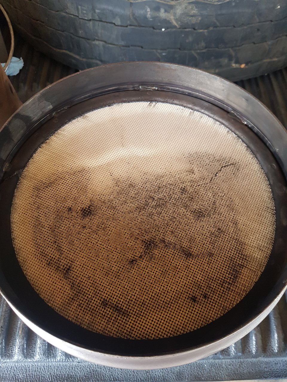

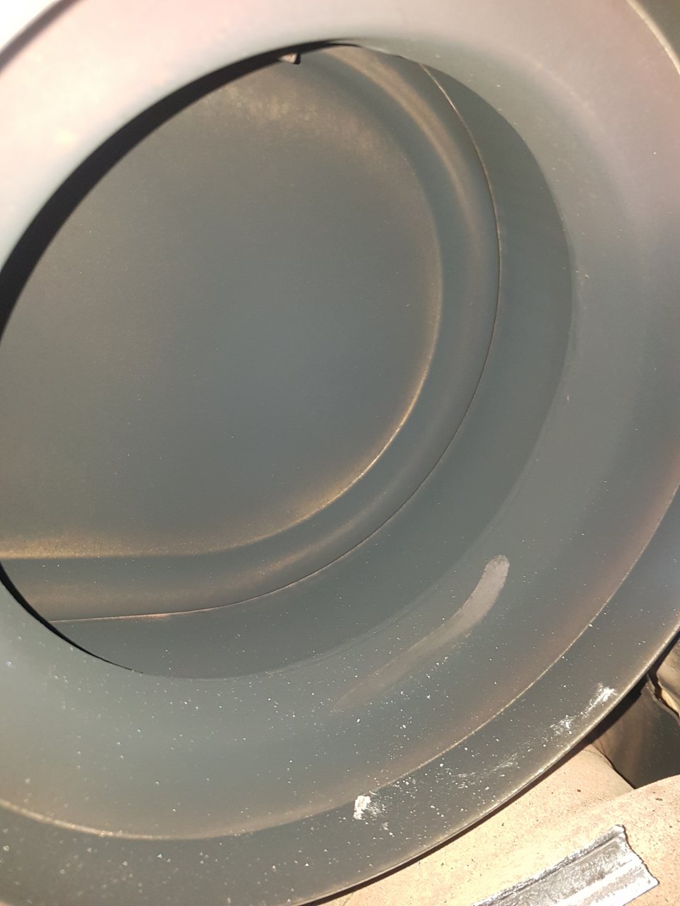

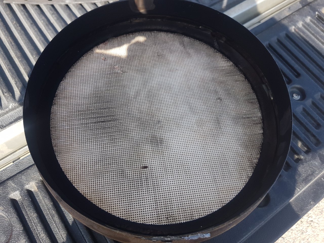

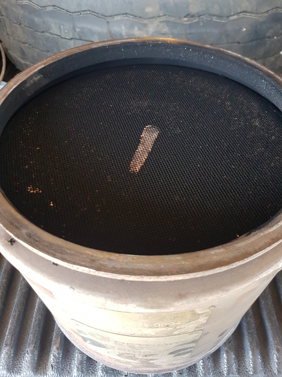

    Detroit Techs say change injectors at 700k miles. They get worn, overspray and make this kind of mess. They also recommend overhead adjustment every 250k miles .
