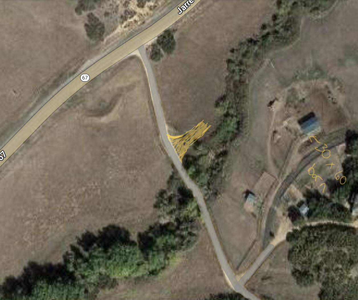

  6. TripleHRanch
    TripleHRanch Bobtail Member
    Joined:
    Nov 14, 2023
    Messages:
    8
    Thanks Received:
    9
    Hopefully the picture comes through. To give some perspective, the barn is 30 x 50 and the other smaller building is 20 x 20. The trees down the middle is a stream. The road is dirt. I marked where we were thinking of creating a pad (gravel). Its pretty level already, would obviously have it graded. Do you think this is possible?

  8. mitmaks
    mitmaks Road Train Member
    Joined:
    May 16, 2014
    Messages:
    2,576
    Thanks Received:
    2,087
    Looks like if driver comes off of hwy 67 and heads south then he can back into that area and once unloaded get out of there no problem

  9. TripleHRanch
    Joined:
    Nov 14, 2023
    Messages:
    8
    Thanks Received:
    9
    Right, I don't want to cause issues for the drivers, which is why I'm asking what is possible and what is ideal (although I know I can't get to ideal, I'd like to get as close I can). I just don't know what size that pad would need to be, which is why I'm asking.
  10. mitmaks
    Joined:
    May 16, 2014
    Messages:
    2,576
    Thanks Received:
    2,087
    I think 40wide by 100 or.so long should be sufficient for any truck
