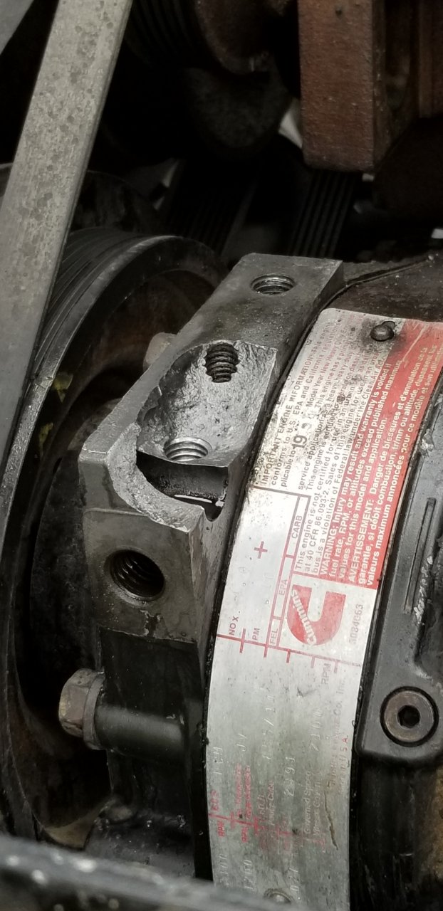

    Welding would ruin the seal as too much heat. There were about 3 threads left in the hole. I bought a tap and ran it to the bottom of the hole, probably has 6 or so threads now. Slapped the old piece on with some jb quick and threaded the bolt on. Added some extra support brackets to minimize future vibrations.
    Rideandrepair and tommymonza Thank this.

    There's 2 1/2" bolts that hold the compressor bracket down. One was not damaged at all so I felt pretty good about it with additional braces added. Screenshot_20181007-214355_Gallery.jpg

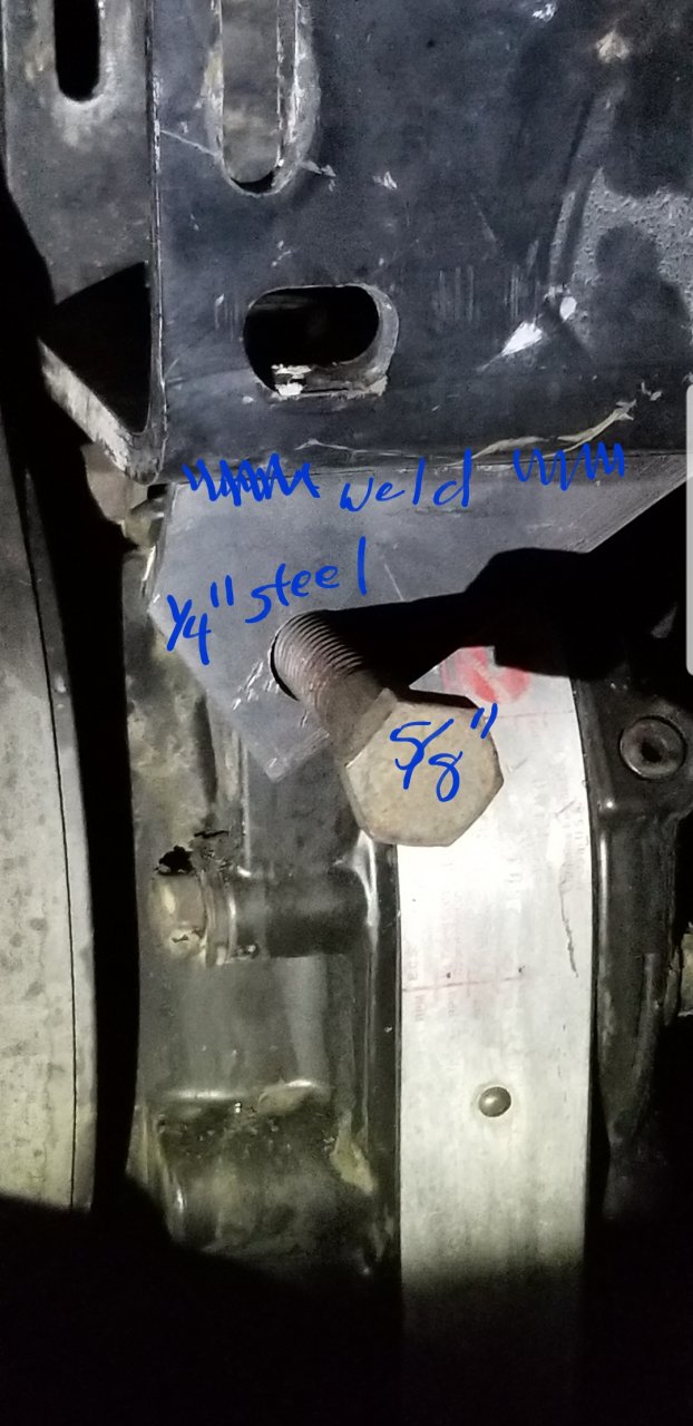

    I just used a square plate that was solid, or a complete circle, around the the 5/8's side bolt in a case like that. Welded as you out lined.
    Have had problems with bolts on top in cases similar to this. Using studs as described worked better for me.
    Let us know how that works out please.

    Doesn't appear that the bolts were threaded very deep into those 2 thread holes that busted out.
    Proper length bolts and lots of locktite I feel would go a long ways on my truck.
    Ty
